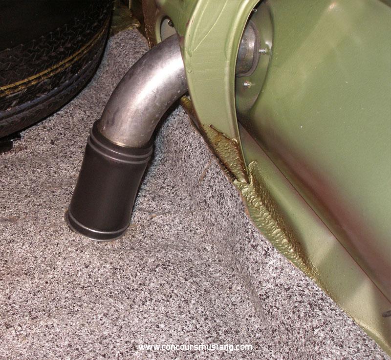

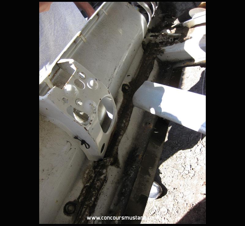

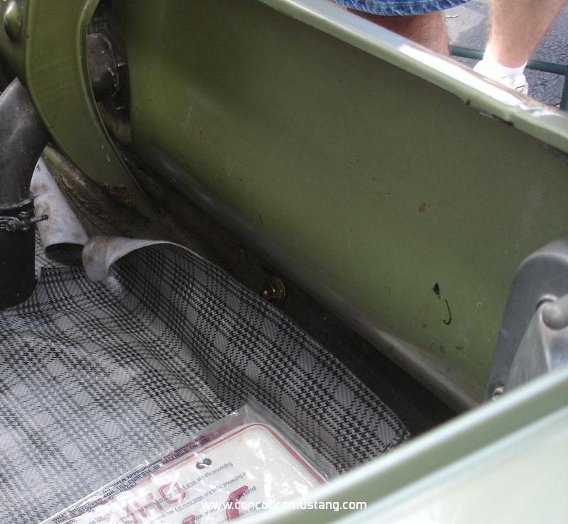

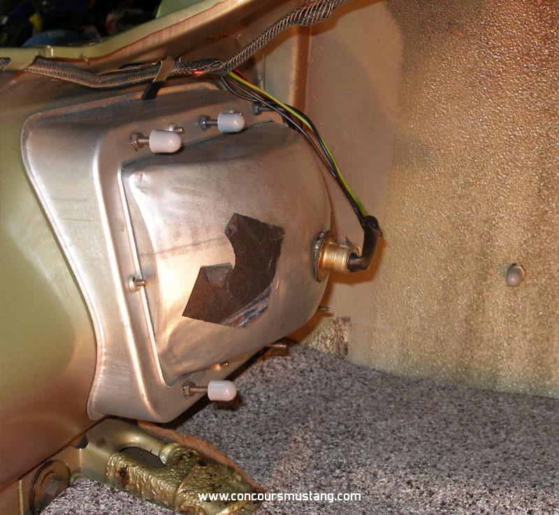

Those are great photos showing what sets to be exterior color all along the inside of the tail pan, where as mine appears to have primer under the black exterior color. Also you will notice in my top photos the bare metal that does not appear to have any red oxide at all. Also odd that that paint was just missing completely the I got the car. It is almost as if either the paint did not stick or something caused all of the paint to lift off. At any rate it sound like my paint guy needs to spray the red oxide as you described and the body color as well. Just curious how far into the trunk the body color goes as the whole floor of my trunk is black, but not sure if it was painted after the fact. Was the trunk lid painted on or off the car? Is it safe to assume that most of the floor of the trunk would have recieved black or overspray, not my car is a back car.
Trunk floor, most of the taillight panel (can be weak out at the very ends), rear quarter panel surfaces that were vertical,  the end of the wheel wells that are visible from standing behind the trunk and panels that are vertical and are between the trunk and the interior normally got a nice coat.  Remember there would be a bare metal shadow around each (one each side) where the retainers were that held the unibody to the skid or dolly it traveled on when being painted
