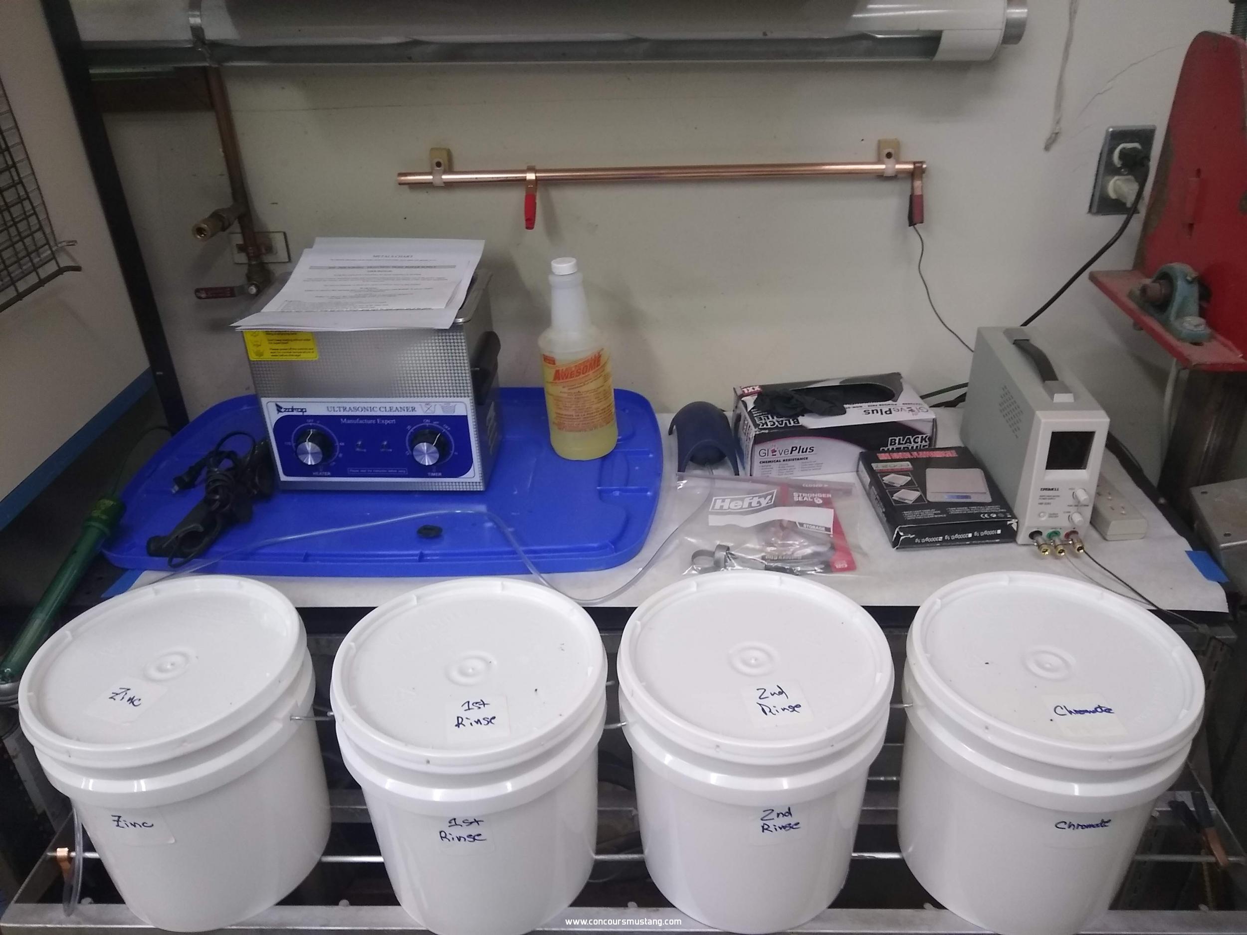

Here is my setup:
From left to right:
CopyCad Mix
Distilled Water Rinse Bucket
5% Muriatic Acid in Distilled Water
Yellow Dichromate Mixture (Zinc Dichromate)
In the background is my Digital CC Power Supply (PS) and an ultrasonic cleaner.
On the floor is a bucket into which I spray distilled water on the part after a rinse in the rinse bucket.

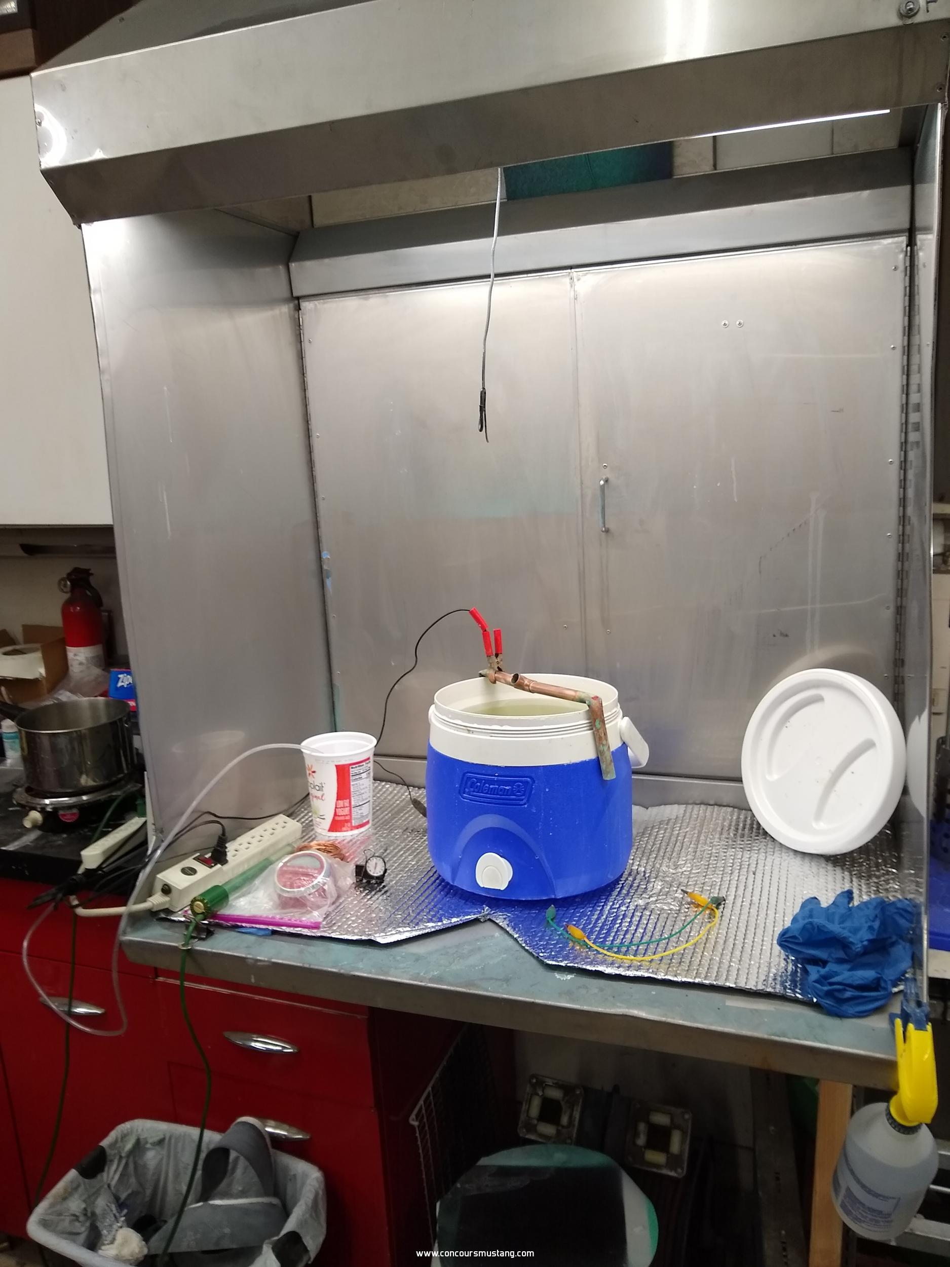

Since the pic of the lined up buckets I moved the CopyCad mixture into a fume hood.
Because the earlier CopyCad mixture requires 110 degree I sourced an insulated drink container (2 gal) to keep the mixture hot.
The hood is next to the other buckets.  I still use the acid mask while the hood is working.

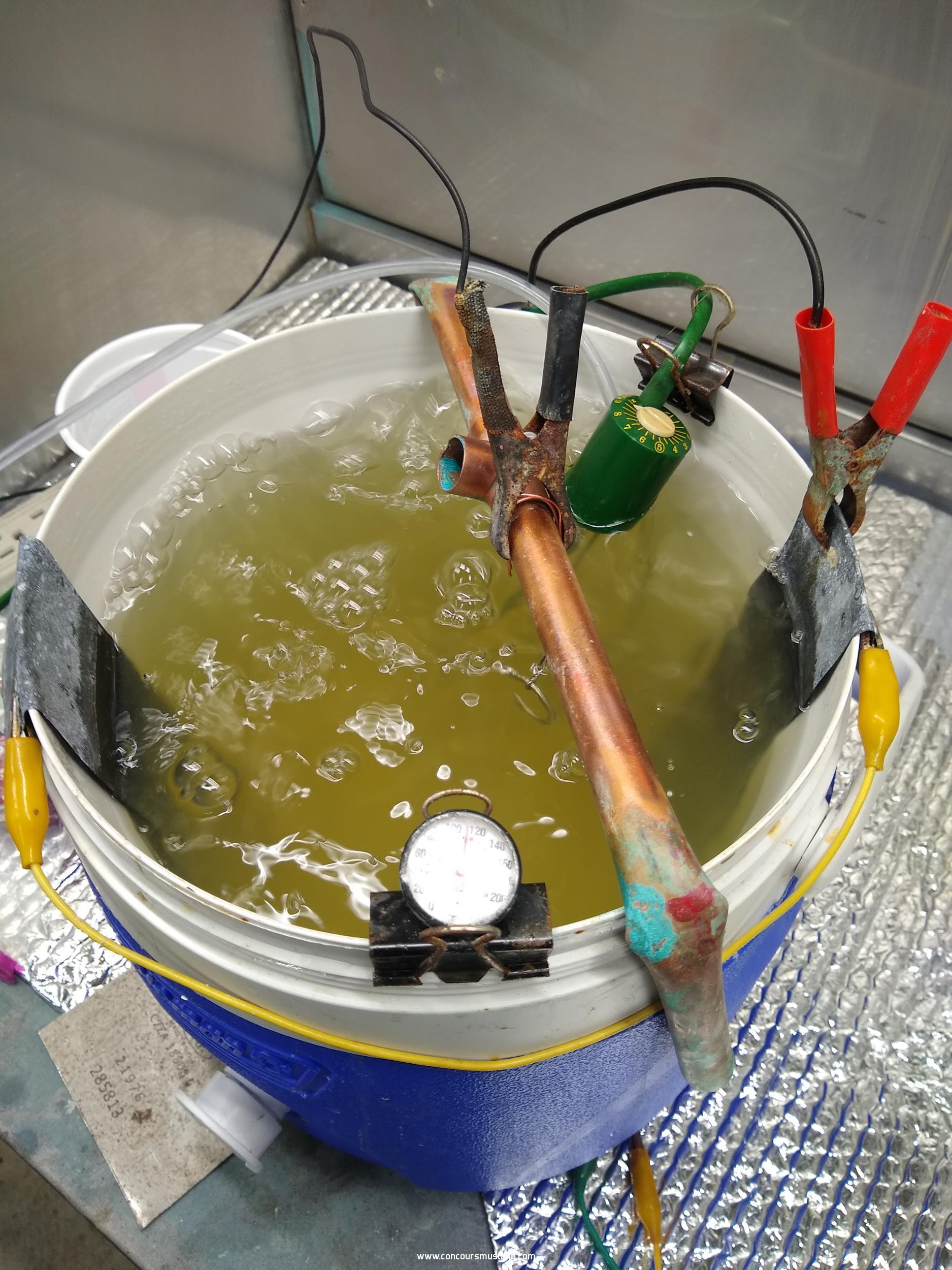

Setup of the CopyCad Bucket in action:
The two pieces of zinc (anode) are bonded with an electric lead. The large red lead to the PS (+).
The copper pipe has bent over ends to stabilize. The part is copper wired to the pipe.
The small clear line is an aquarium bubble producer. Place it to the side.
The large green item is the aquarium heater.

You need to read the instructions on your PS on how to set it Constant Current (CC). When used in this manner the voltage is set at around 3V initially and the output amperage is set for plating an item of a specific size. The voltage will change but the amperage will stay steady during the plating process.
Mix the CopyCad according to the directions. Use only distilled water. Cut your zinc (at 99 percent pure) to the height of the container. Make two and  bend them over the lip of the container. Take out a alligator test lead and join them on the outside of the container. The red lead of the PS goes to the zinc or anodes.
Bend a copper pipe to bridge over the edges of the container. You will need to clean this pipe often. Other alligator or battery terminal clips will join the negative lead of the PS to the pipe or the copper line leading to the item to be plated.
