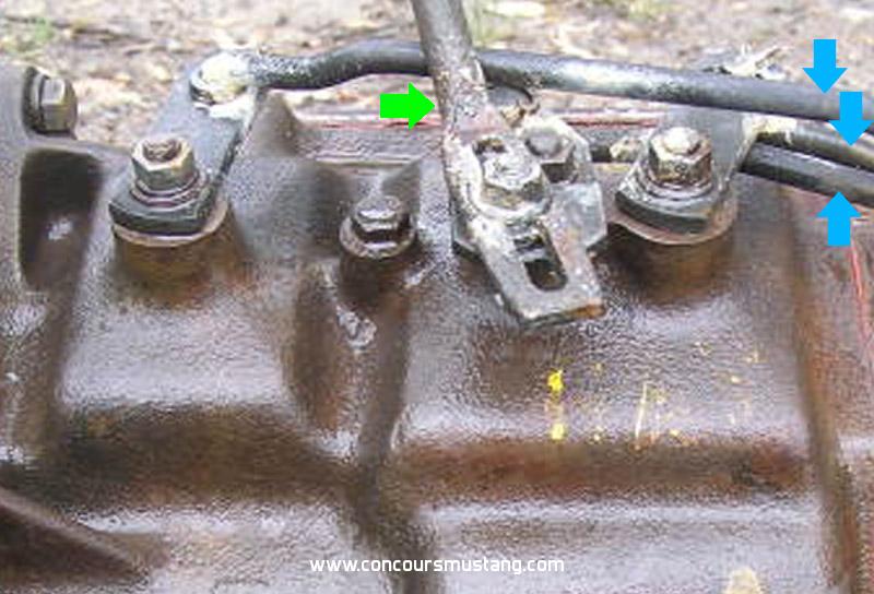

Here is a 70 4 speed examples - they used the locking steering column arrangement also
The center arm has to connection points one top, one bottom. The three rods (blue arrows) connect to the shifter. Lower one goes to the center arm on the trans \
The one lower connection rod (green arrow) attaches to the steering column lower end so that it can not be moved once the car is locked by removing
the ignition key

Ok that 3rd hook up if I follow yo7 is probably the key lock. That makes sense now.
