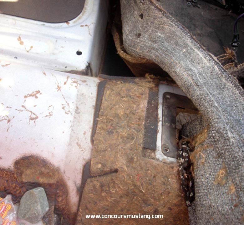

Agree with Bob on the layer of jute attached to the bottom of the original carpet in areas. Typically missing on the seat riser sections and up towards the rear seat on many years and models
At the bottom half of the picture on the right you''ll see the upper jute payer has become detached from the carpet but on the upper its still attached. Below you can make out the darker composite jute underlayment.  In other sections you can see where no layers were present or just the carpet jute was
