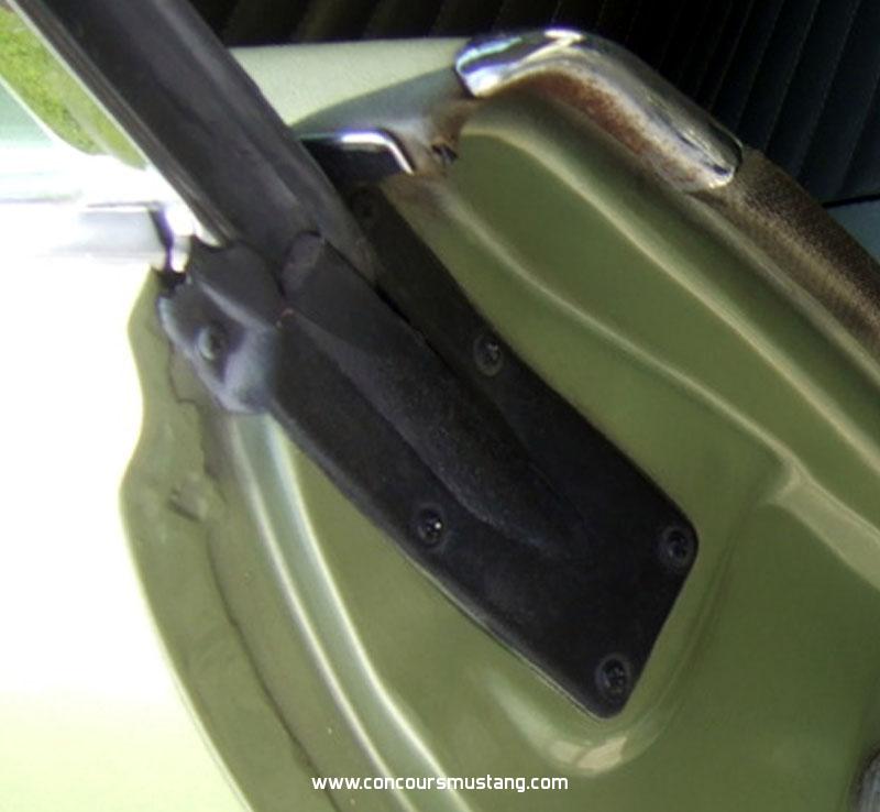

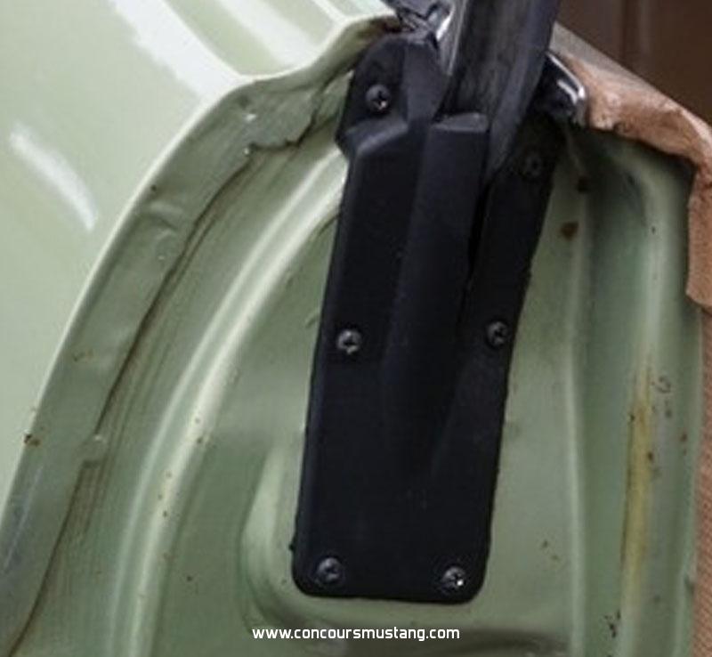

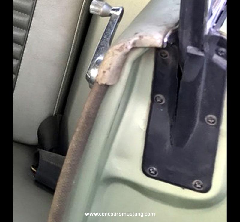

Need to replace quarter window sealing
I'm struggeling which one is most correct. Early built Nov. 1966, SJ. Convert.
Didn't find anything in searching.
C7ZZ-6528182/183 ?
Found these (all repros, named 67/68, different style):

Think these should help you choose

If I see it correctly there is a cut/slice. So second version would be the one.

Yes the preformed(trimmed) slot for the window is visible on the lower two (7R15xxx-18xxxx examples)  but it cracks and tears over time from use and age
