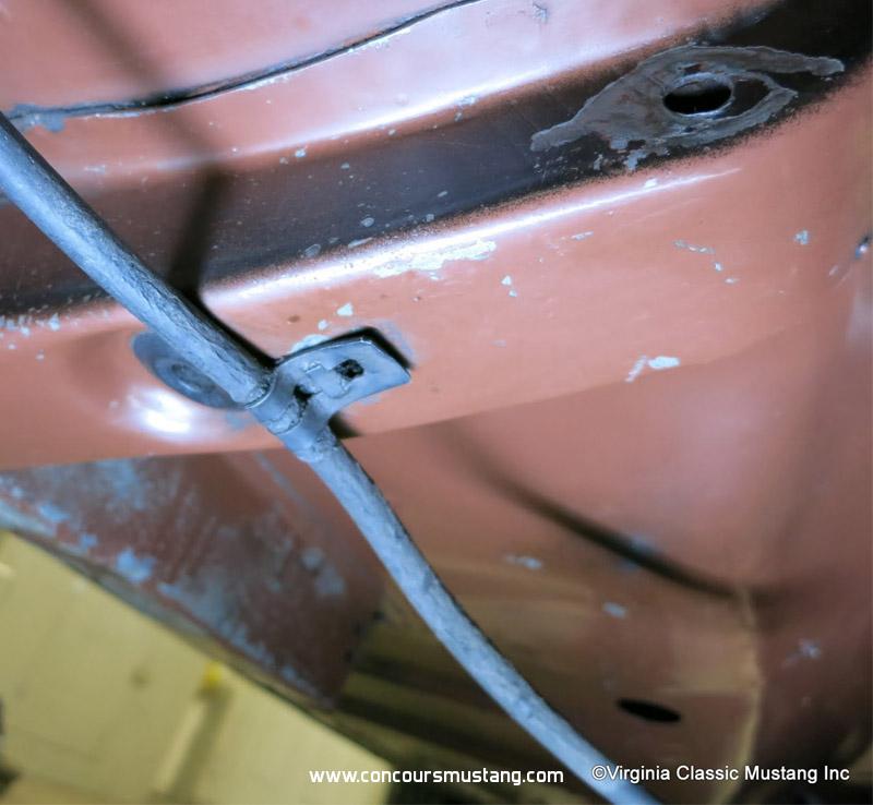

Hi,
Does anyone has an assembly pic how it looks like?
Great thx.
Ralf

I mean how is the clip attached to the crossmember, respectively where is this clip exactly being used.
Re: Speedometer Retainer Clip at Transmission Crossmember Brace
« Reply #3 on: August 16, 2019, 08:57:52 AM »
Ralf, the clip you show (with 'incorrect bright zinc finish) secures the speedometer cable into a pre-punched hole in the transmission tunnel crossmember (not the "bolt-in" crossmember). It attaches by pressing into the bulge in the middle of the clip and the prongs on the back side will expand (same principle as the fuel line retaining clips).

« Reply #5 on: August 16, 2019, 09:27:15 AM »
Thats why. Thx.
Its always described on different web sites to be used in crossmember brace.
>>> This clip retains the speedometer cable to the transmission crossmember brace. This keeps the cable from moving around undercar, preventing damage.
« Reply #9 on: August 16, 2019, 04:14:30 PM »
Reposting of a close up Brant posted. Other side/transmission type but same practice
« Reply #10 on: August 16, 2019, 08:08:59 PM »
Notice no "bright zinc" finish.
