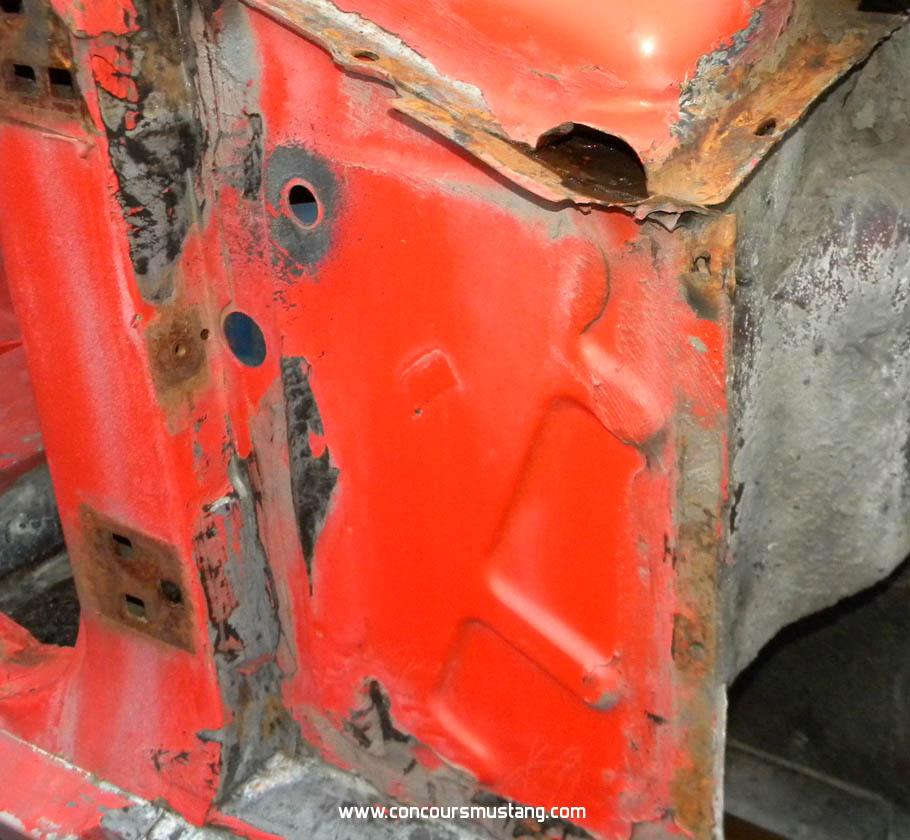

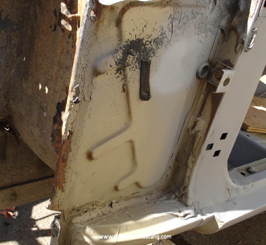

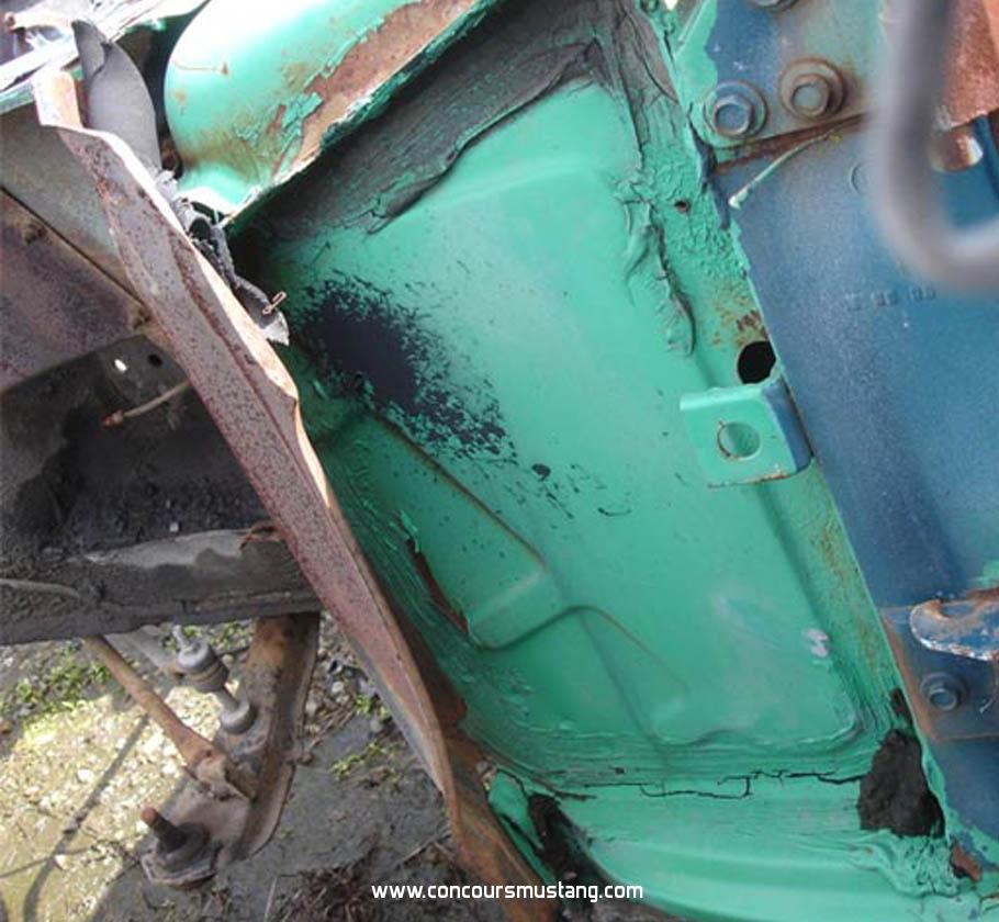

Believe San Jose used a mask or some other form to limit the black overspray back towards the rear of the car. I've not see a large fuzzy overspray edge like those found at other plants especially at the sides where the splash shield will attach
Some examples - No example of overspray along the top and outer edge. The "soft" edge that is often done incorrectly on show cars is at the top of the inner fender where the fender would bolt to on a San Jose. Sometimes a little sharper and other times softer or slightly fuzzy as if someone held a mask made of cardboard or pulled a piece of material folded over along the edge as they sprayed
Car below has two little spots were it looks like someone sprayed a little spray can of gray after the fender was removed
Some of the black you see is where the exterior paint has chipped or peeled off of the sealer below
Thanks very much Jeff, those pics really clarify it, good to see pic#3 with the fender splash shield still on. We'll leave the car as is and continue assembling...
Interesting how all but one have a little "spritz" of sound deadener. Did that get through the notch at the inside corner of the splash shield?

« Reply #8 on: February 24, 2015, 11:43:19 PM »
Also interesting to see on those examples that it just relates to the drivers side, the one pic of the passenger didn't have any...
Looking at the pattern doesn't look like it's come through the inside corner to me, there is a plug around that area from under the dash, looks like they give it a quick squirt of deadener for some reason, possibly to stop it rattling or to stop air coming through... just my assumption...

« Reply #10 on: February 25, 2015, 06:11:42 AM »
No that was applied after paint - likely when they were sealing the firewall pass throughs I would guess. Meant to seal that post from the interior wire loom clip/retainer that sticks through.
The access hole plug seems to have body color paint on it and it seems to be on top of what may be the original color. You may need a disclaimer for this.
There's more than one repainted car.
Not body color but a rattle can squirt once the fender was removed in the yard. I some times mark cars so that I know which cars I've documented the next time I visit - but this is not one of my "marks" Posted a description with the picture in my post so no one would confuse the small rattle can squirts at the upper left  and the upper right of that panel
"More than one"? Guess you might  be referring to the green and the burgundy cars that had an exterior repaint that didn't effect the area or  details discussed in this thread. Guess I could have cropped those so that some would not get distracted :)
