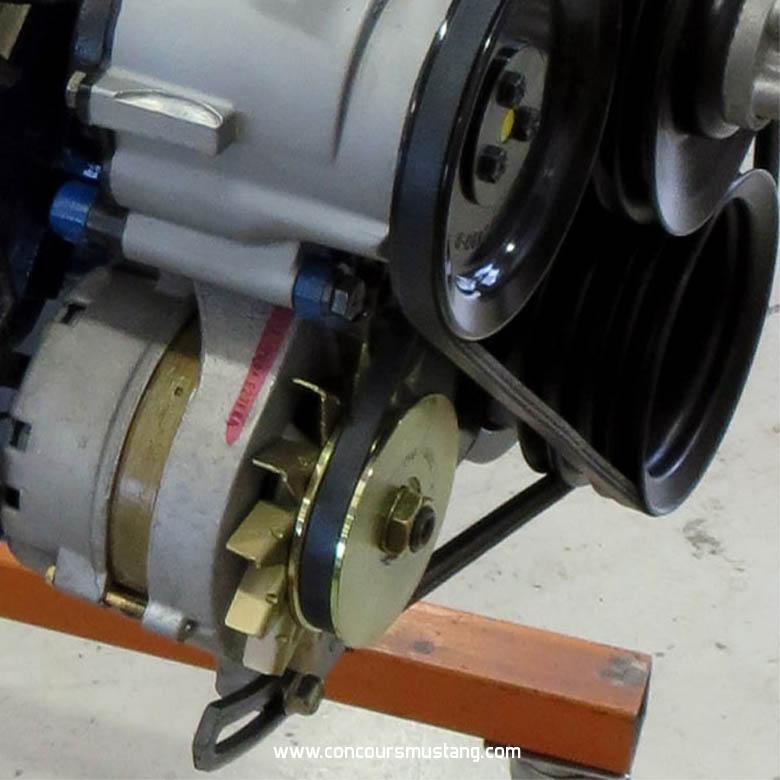

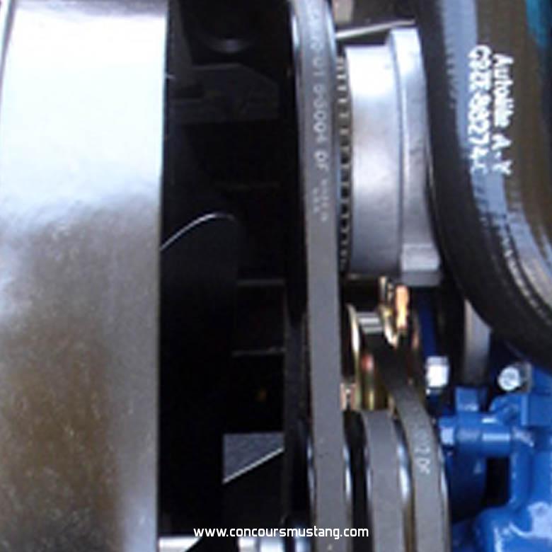

Believe you'll find that it's a C5AF-10A352-H finished in zinc dichromate
http://www.concoursmustang.com/forum/index.php?topic=12273.0
Hard to get a picture of in the car due to the smog pump and other things getting in the way
From my build

Just as a follow up on this older post so that someone does not go astray. In more recent time its been reported that a number of original 69 Boss 302s have been seen/found with the smaller dia stamped steel pulley on the alternator so the subject needs some new attention and documentation to see if the usage is a running change and what an approx change date would be. Stay tuned :)
