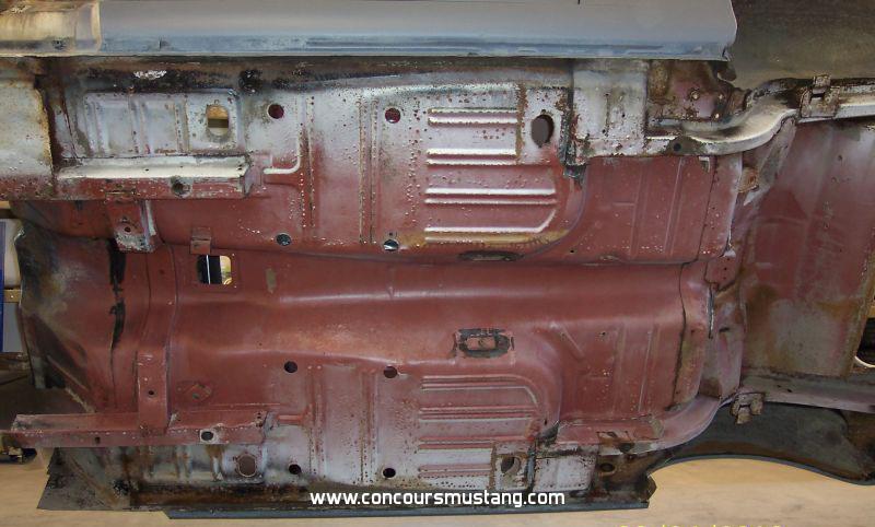

Here you go. Some of these may appear familiar as they have been used in other threads/responses
Hope they help
Example of one of the tints used during this late part of the production year

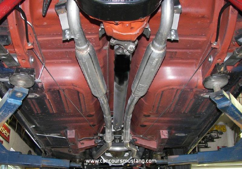

Dark exterior car (dark blue) so the pinch weld black out and exterior color all blend together on this example

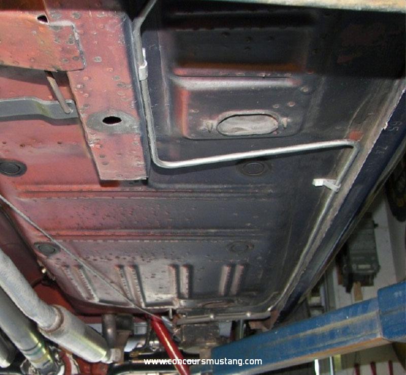

Same thing going on in this one also
Easy to see some of the pinch weld black out has been cleaned or fallen away over the years

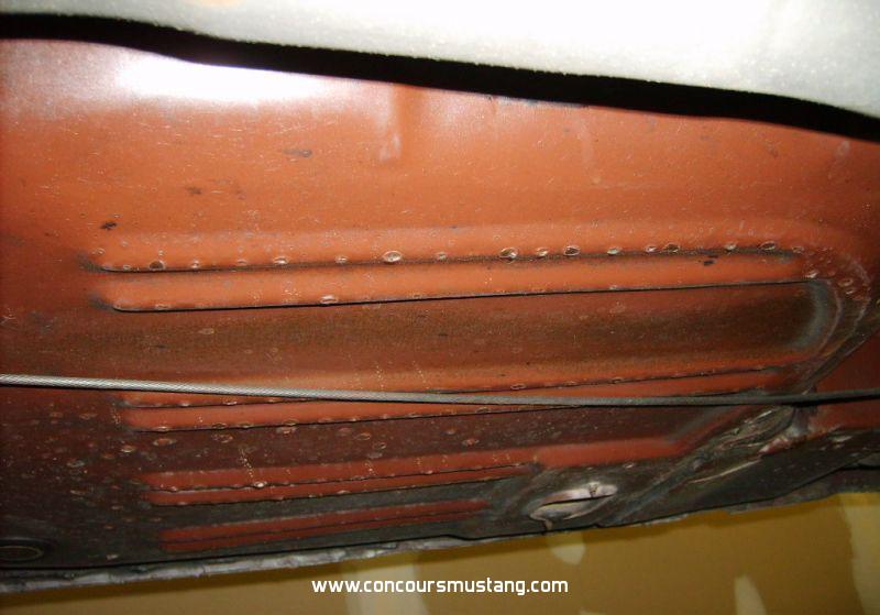

Less black out overspray on this example may be due to heavy cleaning
