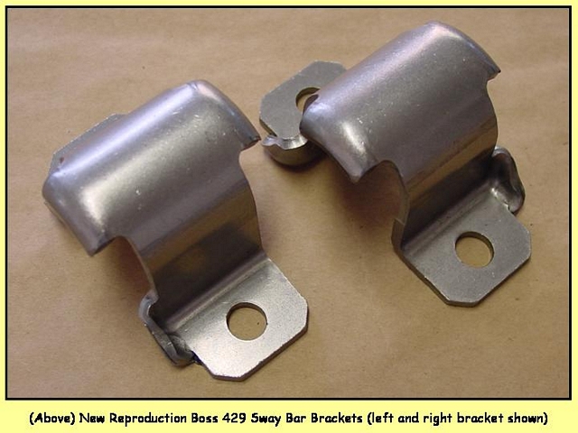

Re: 1968 Ford & Mercury 15/16 sway bar bushing oem design?
« Reply #5 on: August 12, 2019, 05:14:40 PM »
I've found using a phone to do anything other than check for active posts and take pictures (not view them) is not very useful. There are many details you need to see and you really need a large desktop screen or at minimum a decent laptop.
Someone has just manhandled and squooshed a smaller bushing in there and to make that work, replaced the bracket.
Here is the correct bracket:
