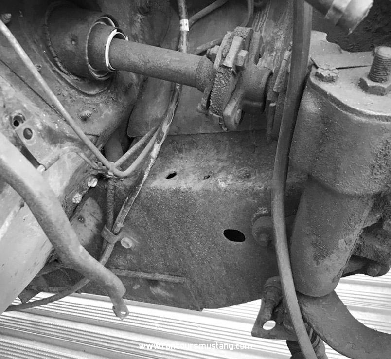

  • Posts: 24867
Re: 68 zbar mounting nut serts
« Reply #5 on: November 17, 2019, 10:38:34 PM »
Would not suggest adding one if your car only has two. Read reply #8 below
Took a quick look only through my 68 Dearborn cars for the holes and inserts and found only two inserts (one unfilled hole) on all of the visible examples. Did have one that is difficult to make out and it may have three.
To show the span of this quick look partial Vin's are posted below. Of course with most cars the area is not visible - engine, master cylinder and the like get in the way. All the following unrestored, apart, in a yard, basically not messed with it appears
8F01C1245xx
8F01C15723xx
8F02R1718xx (pictured above)
8F02R1943xx
8F02R1982xx
8F01C2107xx
8F02R2068xx
8F03C1985xx - may have had three
Started to go through San Jose and the pattern (only two) was how it started out. Will get back to it but changed focus since the OP has a Dearborn R code

Guess I should restate my findings and what I wrote.  Don't get it clear or correct every time so will try again :(
It appears that in at least the 68 Dearborn cars had the forward two rivets installed on every body that was built. Not sure why Ford spent the dollars since it seems to be opposite from what they normally did. Try and save where ever possible. Likely the stamping plant that made the frame rail added them there. The additional one (based on details so far) likely was added at the car assembly plant. Would be interesting to see if that rear one was different in shape or design from the other two though it would never have been seen on a fully assembled car.
Struck out the "don't add..." in the post above.
Did check through my 68 San Jose and NJ cars and they followed the same pattern. All cars with two forward and only the rear one installed if the options required it
