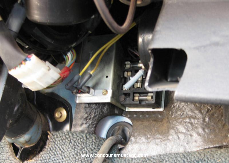

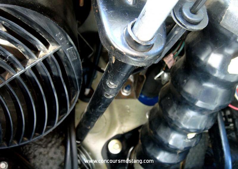

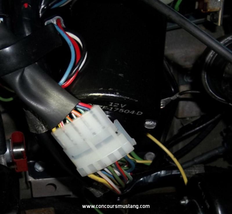

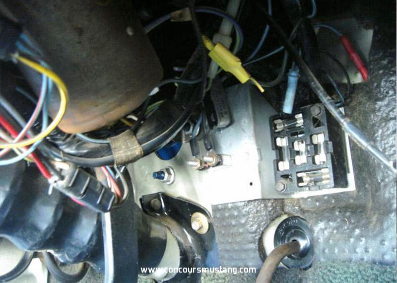

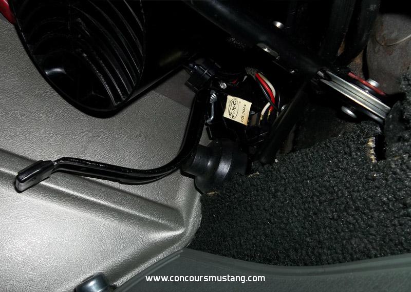

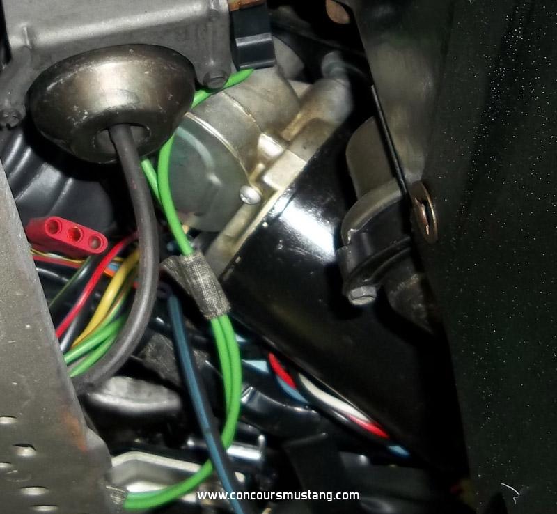

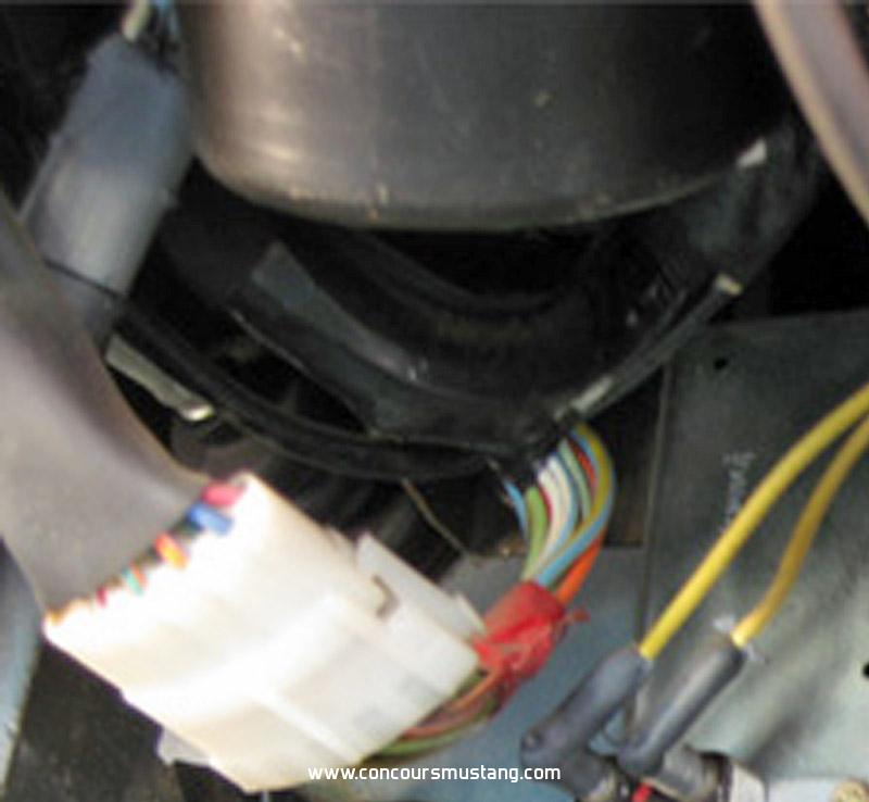

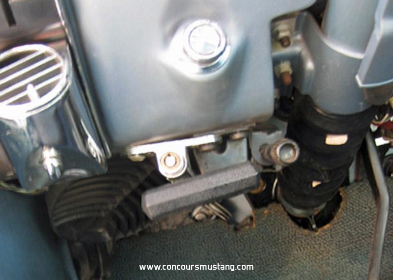

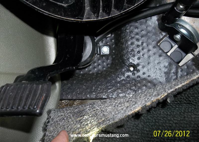

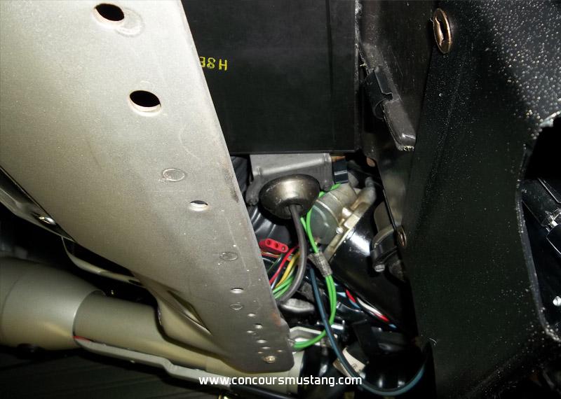

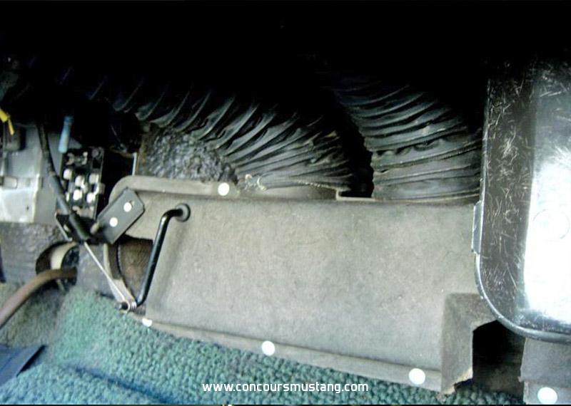

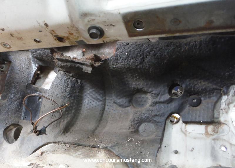

Re: 68 Wiper Motor Finish
« Reply #24 on: October 16, 2021, 06:58:00 PM »
The following posts were separated from a Members build thread as the subject sort of took off and appeared to be a good stand alone topic. So by placing it in the section it will be easier to find and viewable by members and non-members alike. Enjoy

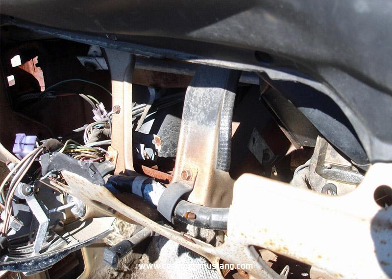

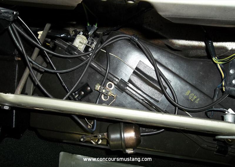

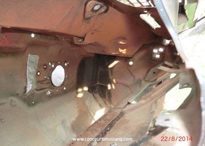

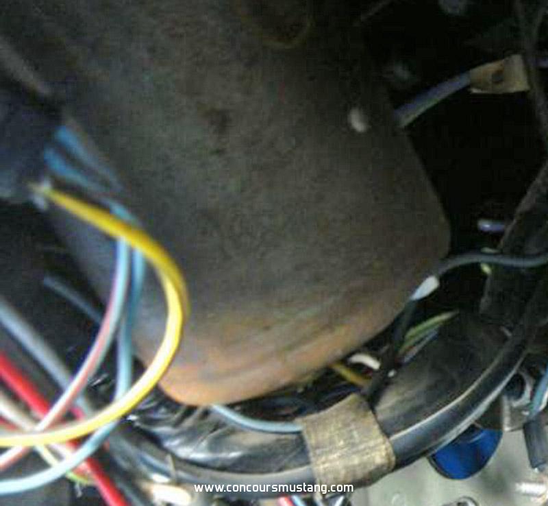

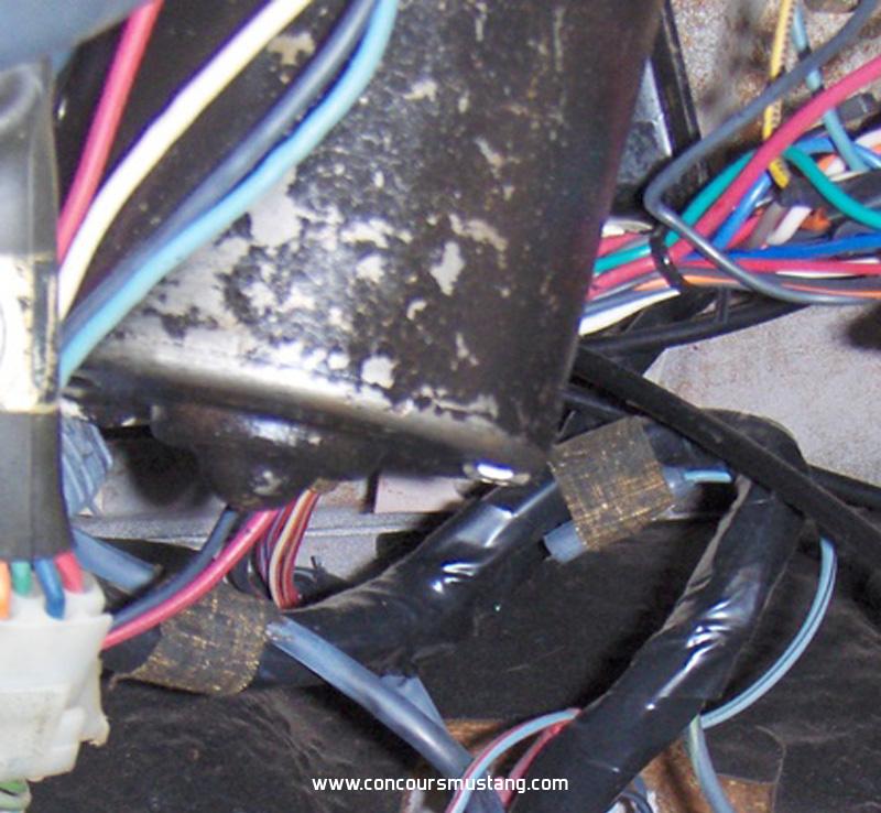

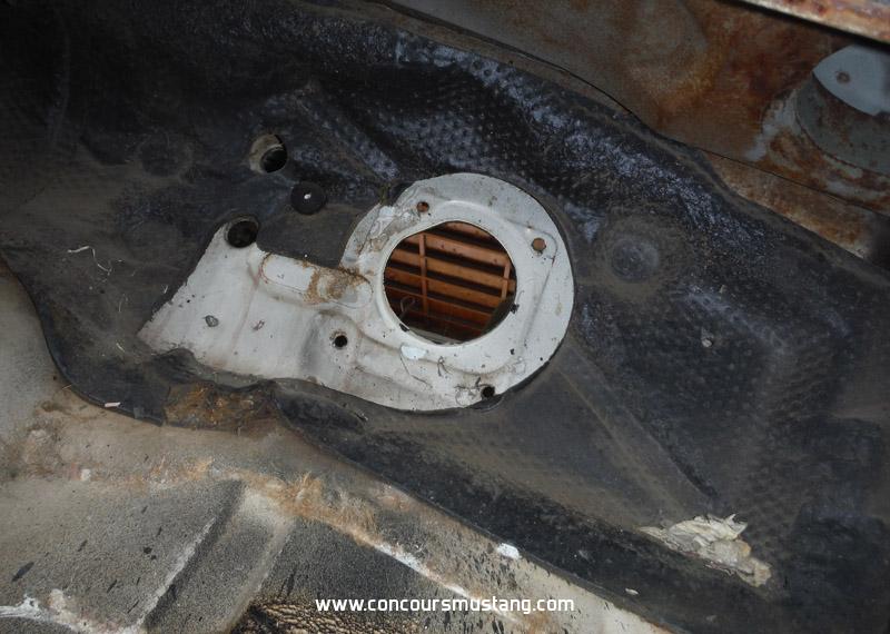

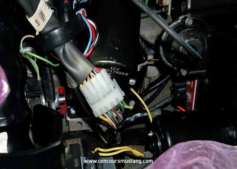

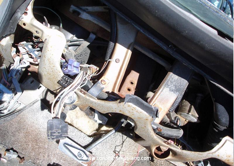

Now that we've moved off of the focus of the original post where it focused on just the particular 68 San Jose build fastback I would like to offer some additional examples so that no one goes away forgetting about the wiper motors that had main bodies painted black
8R1246xx wiper motor appears to be bare steel
8R1267xx wiper motor in black
8R1364xx wiper motor in black
8R1385xx wiper motor in black
8R1673xx wiper motor in black
« Last Edit: October 16, 2021, 07:40:45 PM by J_Speegle »

Great photos Jeff especially the last one as it looks like it has tilt-a-way. I am looking for detailed under dash photos to assist me with my underdash install

No the last two pictures are from the same car and its not a factory or presently a tilt car.
Will see what I've got as far as decent under dash pictures and start a thread.  As you already figured out some of the details will differ depending on options like tilt, AC and so on.
