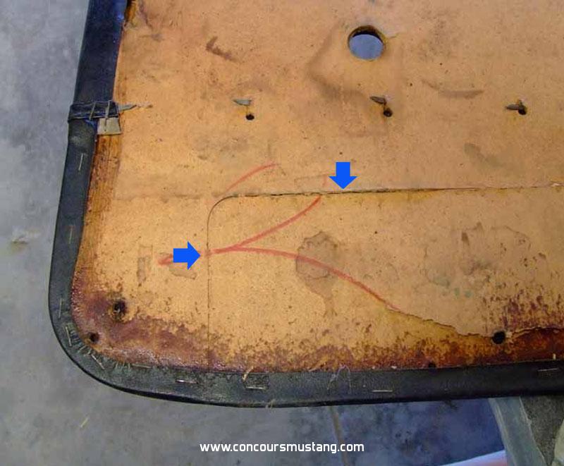

Sounds like the post owner that added the speakers and modified the door and door panel didn't hack the door panels like most to fit aftermarket speakers and grills. Your door panels are likely nicely done since the person doing the conversion wanted it to look factory and they simply used the factory prepunched speaker outline that was designed into the factory door panels. Highlighted by the arrows in the picture below

Bingo!  That (very likely) explains the nice radiused openings in my panels.   Fwiw ,  door panel restoration guy Gene Painter says no problem to fill them back in when he restores the panels.
