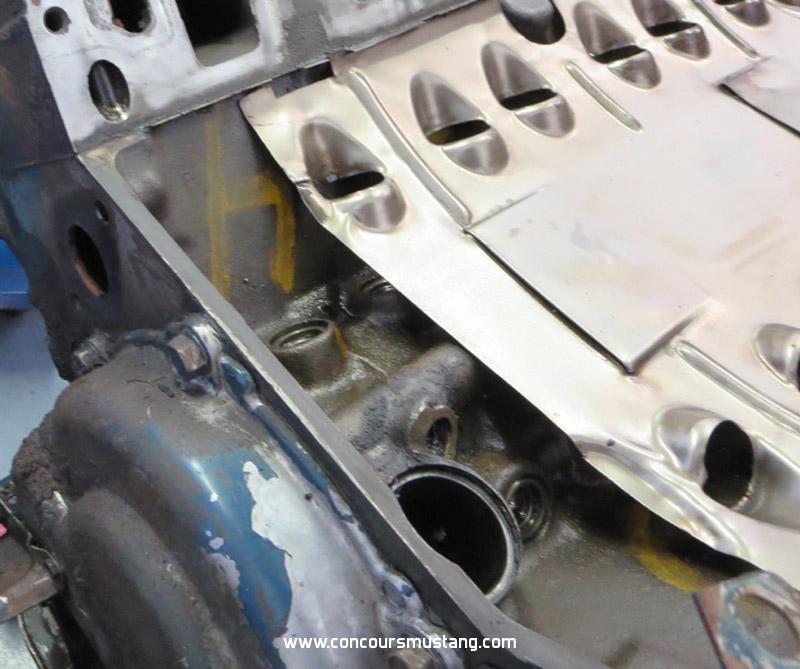

Can anyone advise why the painted numbers in the lifter valley and what they where needed for on my 1970 428 CJ motor.

Those numbers are for piston matching at the engine assembly level. The number represents the last digit of the bore size in thousandths of an inch.

+1  And the workers assigned to that task (measuring and marking the bores) were quick!! Seen this demonstrated in a couple of movies made during the era. As expected. Do the same task over and over for days, months or years you get good and fast
Another example
