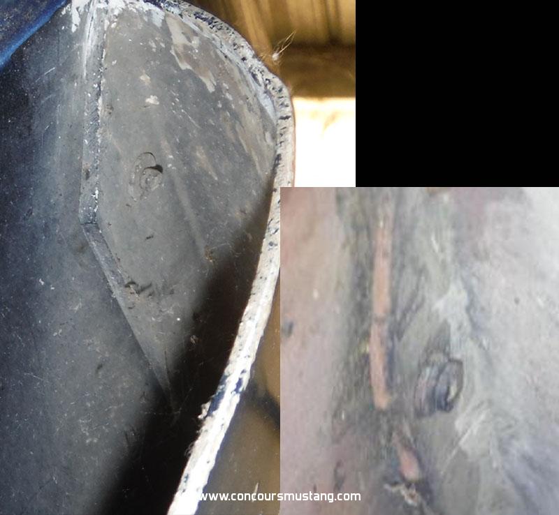

Here's how it came out.  I'm happy with the size of the washer but the rivet looks a bit stubby.  I did one outside of the car and the length looked good but I'm not happy with it.  I guess I'm going to drill this one out and try again.

Here's my opportunity to contribute from my experience.  The image you see of my car (green) is a 3/16" rivet with the washer.  That seems to closely match the images of the original rivets.  The washer shown in that photo is a 1/2" standard washer (not a rivet specific washer).  You can see that the stubby rivet doesn't match the other rivets used on my car so I moved to a 1/16's rivet and it matches the others you see.
I did a 3/16" rivet twice with the same stubby (original looking) result.  The 1/16" comes out with the longer finish but it matches all the others on my car so I'm going with that.
If you use 3/16" rivets and 3/16" rivet washers with a 3/8" diameter I think you can reproduce the look of the originals.

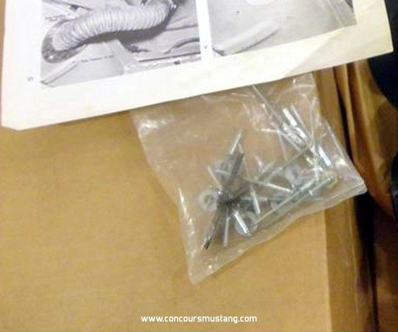

Oh, and the length of the 3/16" rivet is 3/8 - 1/2" range.
Yes you'll need (not going to remove an original at the moment ;) estimate the length by taking the thickness of the scoop and sheet metal then adding for the short section that mushrooms when tightened. Will likely not be of much help but here is a shot of the mounting hardware (side scoops and duct rivets) from a Shelby kit from the period
