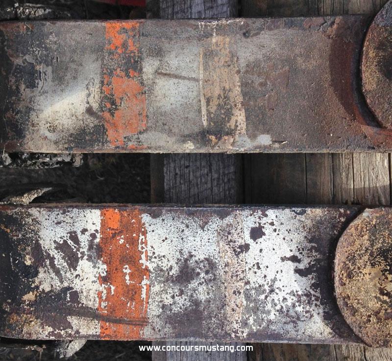

Changed the title of the thread so that we can keep all the related (to plant, car and details) together
Rear springs are shown on buildsheets and they match what we've found on cars
Buildsheets show ORanGe/White and on unrestored cars we've found those colors on C7ZA 5556 AS stamped springs.
Yes drive shaft stripes should be Blue, Dark Blue & Pink
