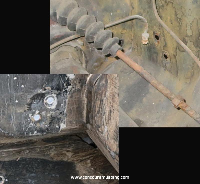

So I want to add the factory disc brake setup to one of my cars. I assume the two raised areas are where I would drill the holes for the proportioning valve? Also what size hole are they supposed to be?

From a couple of 66 examples
They are at an angle from one another
Bottom left taken from the wheel well side - Top right from the engine compartment size
Don't have the size of each hole's measurement handy

I have factory DB on my 65 and both holes are the same size and just a bit over the thread size of the bolt (0.310).
