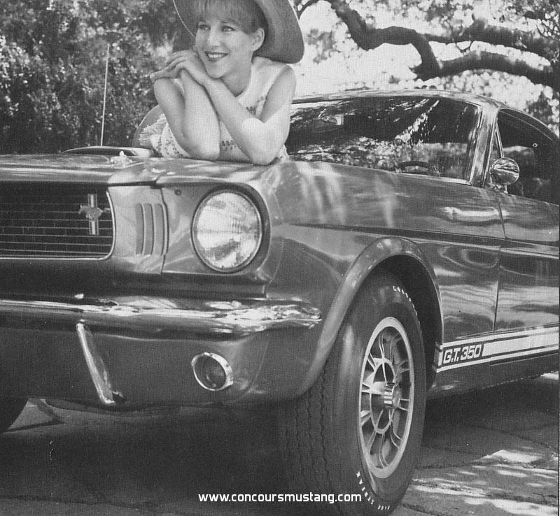

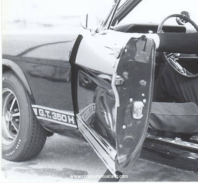

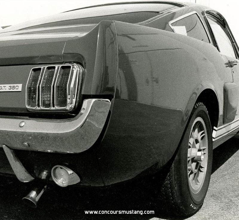

For others viewing this thread. The original tires for 6S1102 would have been the Blue Streaks with the small raised letters as shown below. No visible blue stripe on the sidewall those Blue Streaks were designed for Barracuda's ;)
Tire application coincided with the change from 15" Cragars to the 14" Magnums and 10 Spokes
