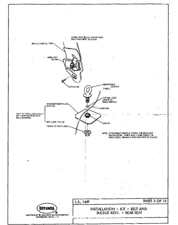

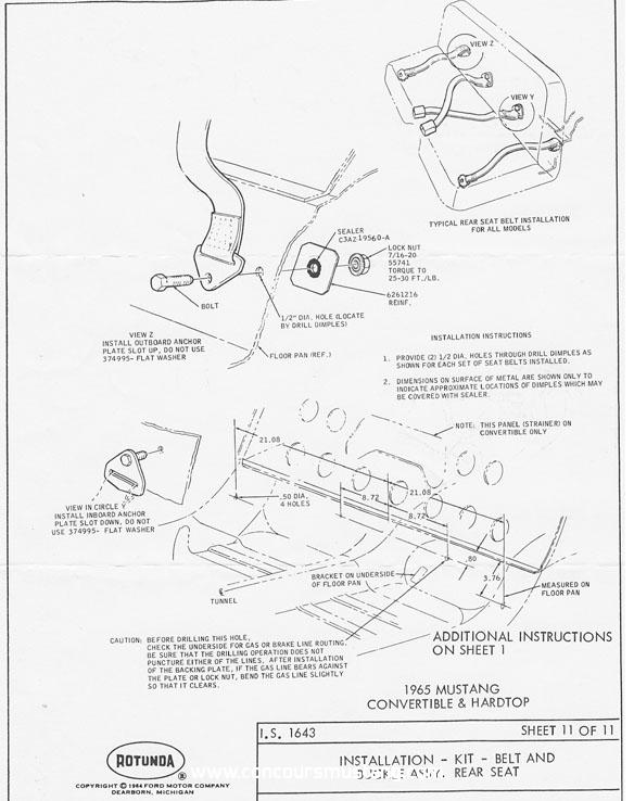

« Reply #8 on: April 15, 2020, 12:21:44 AM »
Here are a couple of illustrations from the instructions

« Reply #9 on: April 15, 2020, 01:53:35 AM »
Yes, thank you, very helpful.
