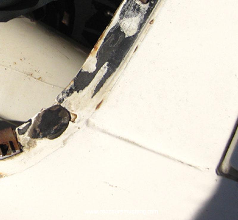

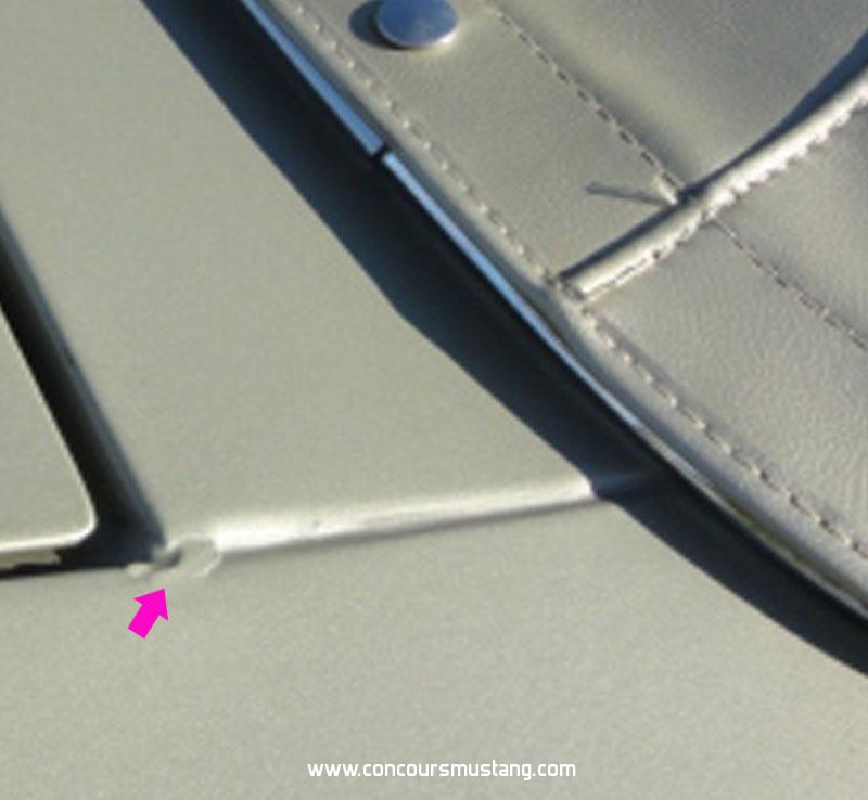

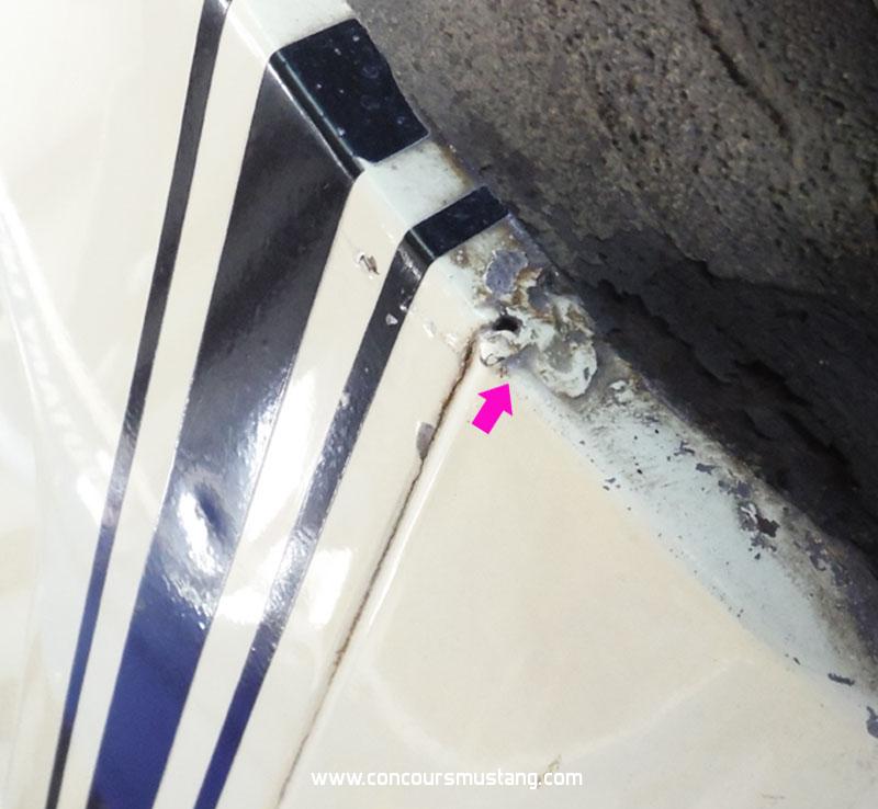

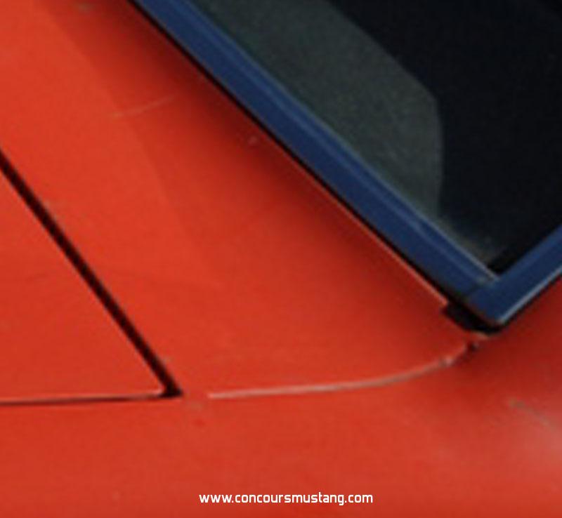

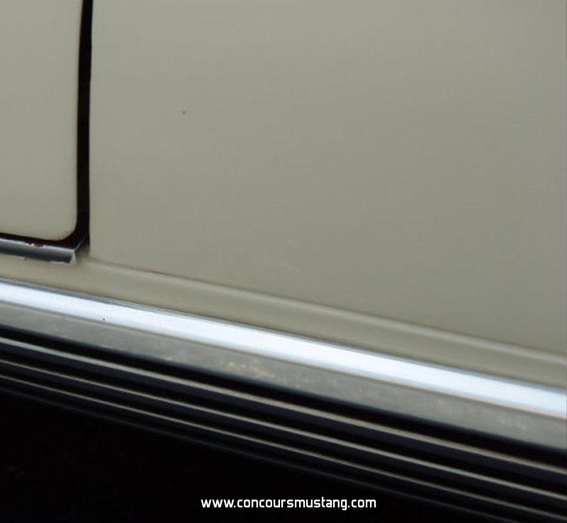

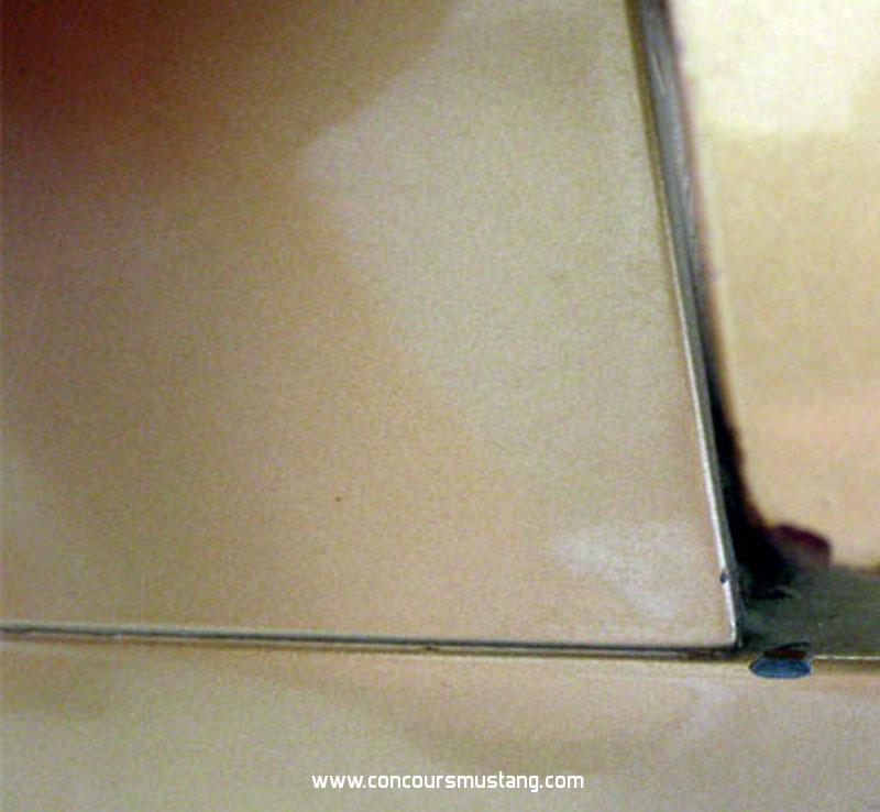

Here are some pictures showing the final look of the process and also a couple of pictures showing the brazed spots you may want to reproduce on the car. Hope these help you and others
Rocker to quarter panel
Brazing at rear wheel well lip
Filler panel forward of trunk seam
Some times the brazing did not fill the gap completely so when the workers ground down the weld it was still visible at one or both ends. Seen it more often at the rear end of the seam as shown in the pictures below.
And a shot of the filler panel gap when pulled apart showing the small amount of sealer that was there - yes it has chipped and fallen off along the edge in a couple of spots . Not much of a gap between any of the panels to hold much sealer
