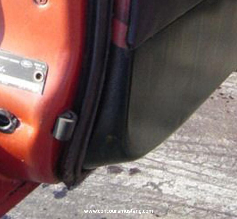

Don't have any pictures of the paint break at the bottom of the door but considering 68 and 70 practices from the NJ plant I think its safe to say the edge between the interior and exterior color was inside the weather strip by approx 1" similar to San Jose and Dearborn
At the rear - the most visible edge - I found the following example masked at a slight angle
