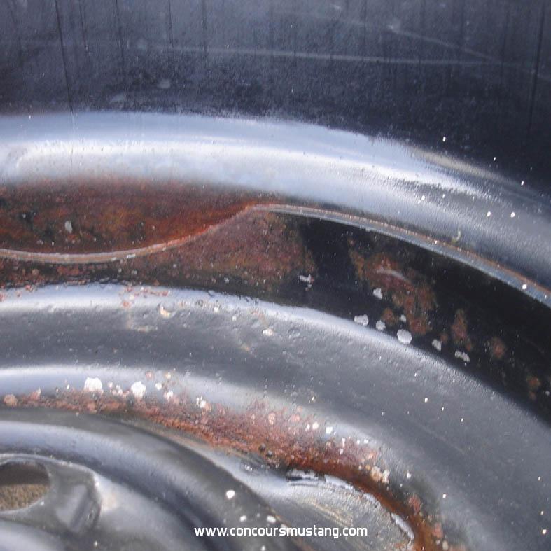

I have found that Motorwheel Corp standard wheels are mostly riveted and their stamping is on the front of the wheel with the stampings on one of the "nubs" next to a lug hole usually with a Ford oval a stamping like "5MB" or "6MD" to that effect..and are pretty commonplace on '60's Ford cars.
K/H - Kelsey Hayes standard rims (a lot less common) are usually all welded and their "KH" stampings are usually stamped inside the inner well cavity of the rims and are not always date coded. You can only see the "KH" stampings when the tires are dismounted otherwise you'll never see them.  Those are my past findings and experiences..

Tony - what time period are you referring to? Have a fair number of 65-67 Kelsey Hayes steel wheels that are riveted only. Now on later ones I see more welding. Possibly a cost saving or in reaction to the issue they and others were having with riveted wheels. - example 69 Shelby wheels
