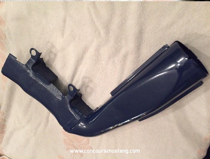

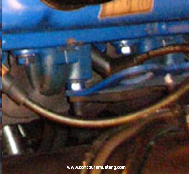

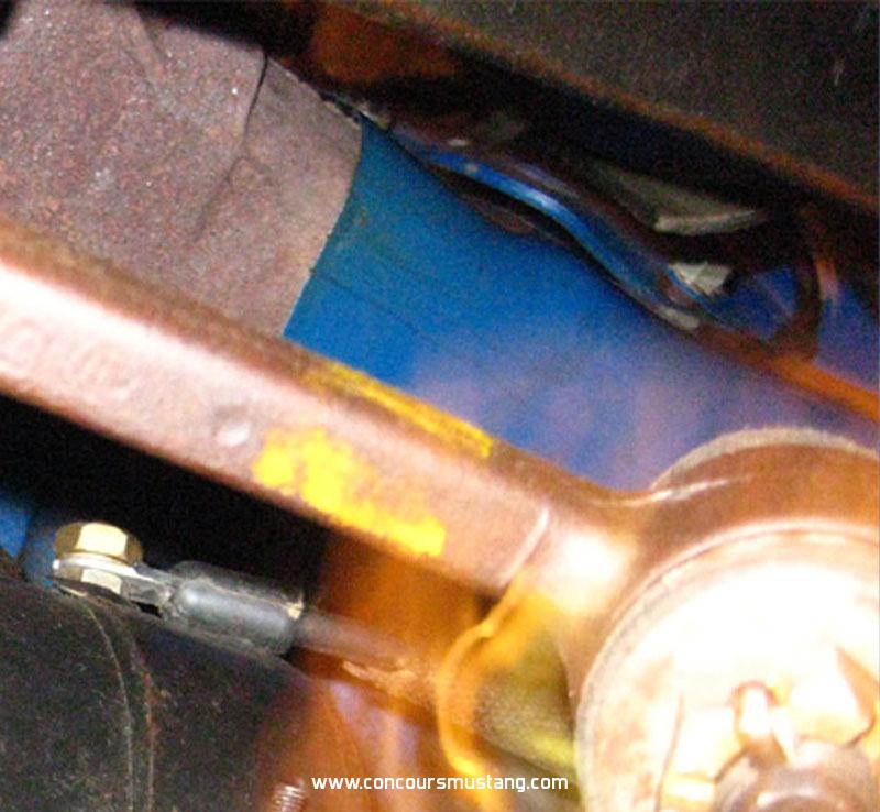

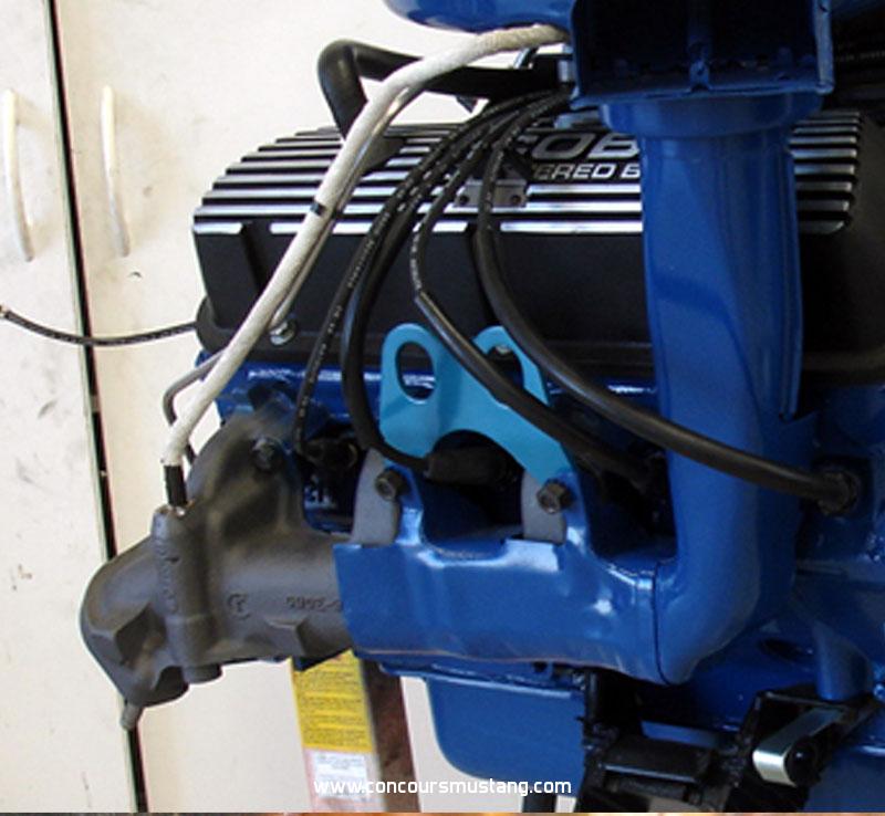

Was described as a 351W
Some (barely visible) additional pictures

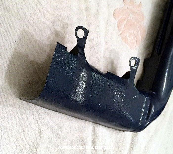

These heat shields are 69351w only and getting hard to find and not repoed . I  have had about 20 of them over the years and down to only a couple left. You have to be carefull removing them since metal mounting tabs are very thin around the 2 bolt holes and often the metal gets twisted off when tring to unbolt them since nit much metal support around bolt holes.
