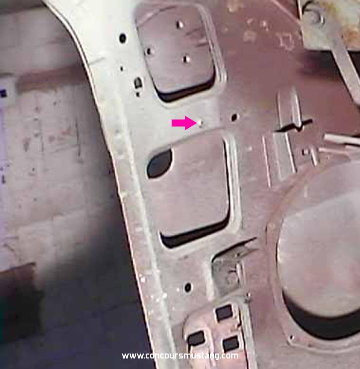

Trying to remember where the door harness grounds go. (I'm assuming the same as Mustang, but not sure)
Does it piggyback on the existing ground screw in the lower dash or go somewhere else?

Same question on the passenger side.

Can confirm that it typically does not share the same spot as shown in your first picture. More likely but have not confirmed on another car that they connect to the hles just below the upper door hing cut out and the one below that opening on the inner body panel.
