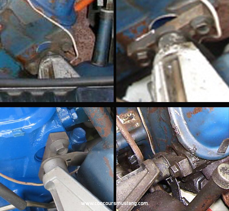

Could anybody please show me by posting photos of the mounting bolts that attach the power steering pump mounting adapter fitted to the driver side head of a May 1969 or earlier San Jose 351windsor mustang.
Please note no air co fitted and the bracket is part number C9OZ 3K505 – A  (attaching bolts 3/8” -16 x 1 1/8”)
Now after my research the bolt part numbers should be: 373162 (note: these numbers do not show up in my AMK catalogue)
Thanking you all in advance

Did you look through the unrestored car section?
http://www.concoursmustang.com/forum/index.php?topic=15252.0
Pictures E1 & U1

These pictures are not close enough for me to see.

Believe you will find that they are the same attachment bolts as used for the alternator adapter/mount
Hope these help

The detail in your photos is excellent and will defiantly help me regarding bolt selection.
