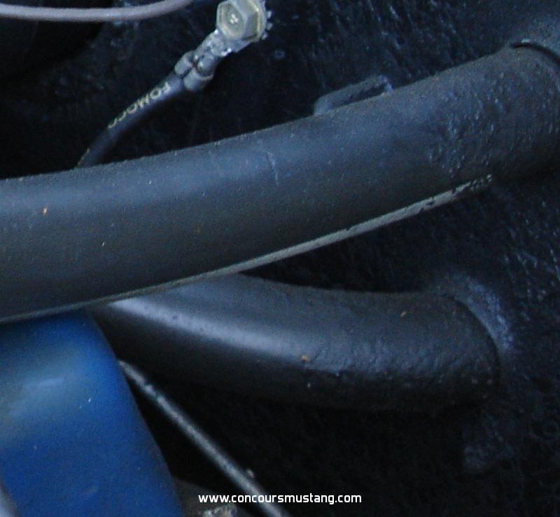

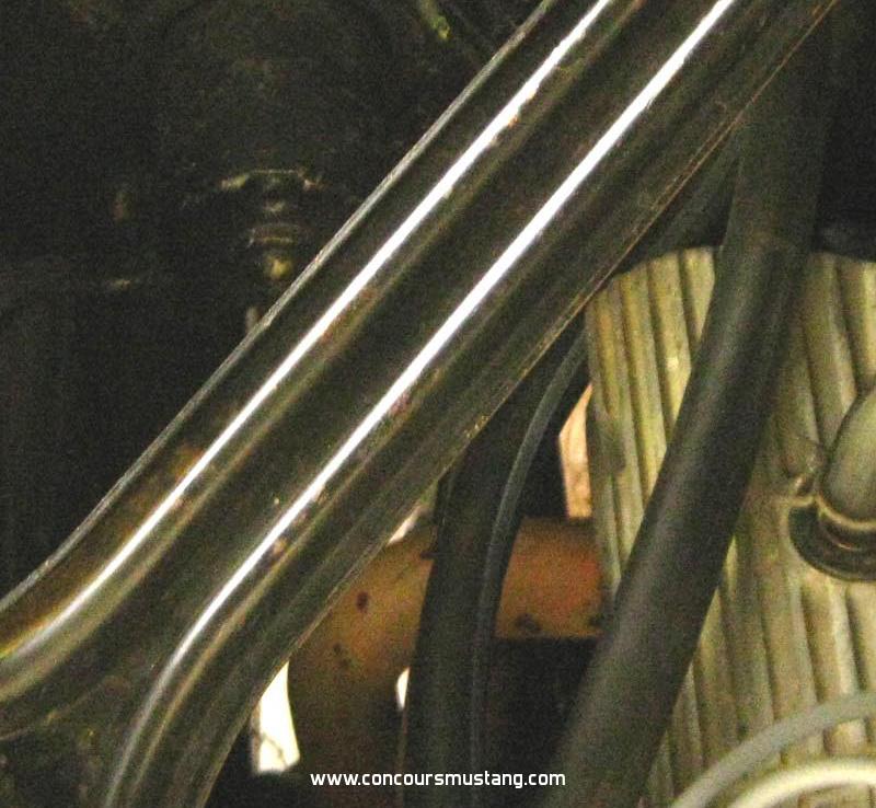

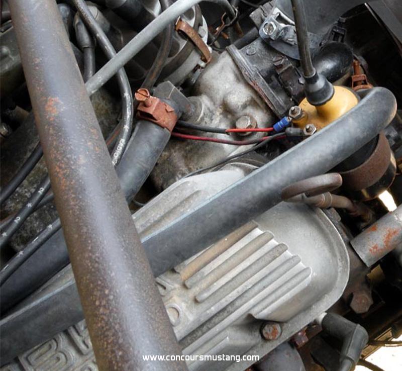

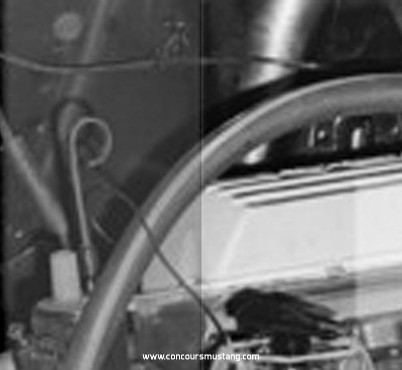

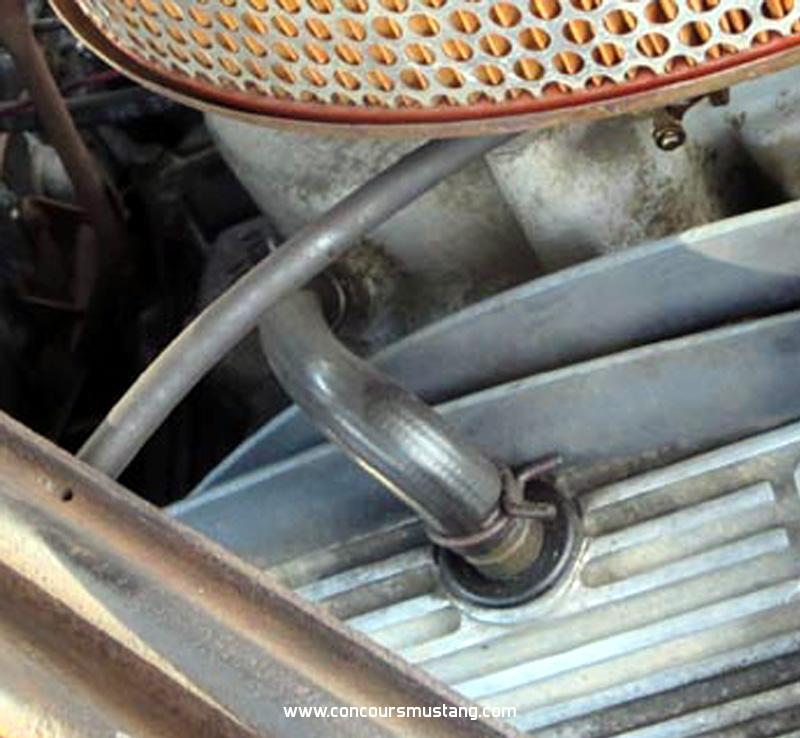

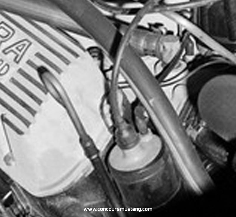

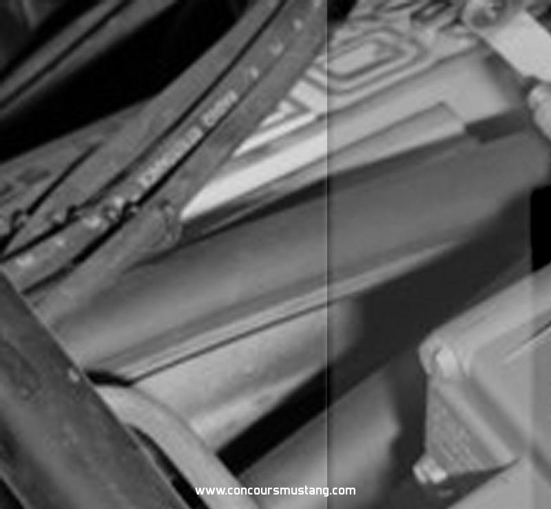

To support and further the discussion here are a few ok pictures from the time period on new or fairly new cars
At least the cars above appear to have hoses striped with two wheels. Gap or no gap would be a result of how well the machine was adjusted. These pictures may illustrate and document one batch of hoses made this way as its not something I've seen on others that I recall
Now for some examples of ones found on unrestored cars taken more recently
Hate when they installed them with the stripe down :) Just makes it more difficult

thanks for the added pictures
The person who did the original post is working on a San Jose built car (based on screen name and other posts on this and other forums) is there any evidence to suggest multiple suppliers of said part and or change in material or appearance through the early years based your knowledge and or images on hand.
to me my hoses in a previous reply match some of your from "fairly new cars" but is difficult to see details from your "time period" examples

As far as the "texture" I can make out some texture in pictures of used hose. May develop over time and depending on the conditions, heat,  chemicals and just age or they may have started out with slightly less rubber content. Bottom line IMHO is that it appears that smooth and lightly textured can be originals based on what I'm seeing. Of course Ford didn't like to single source anything (so they could be held hostage by them) and since the  ribs (number and width) identified the different suppliers I think those things alone support multiple sources. Now if we only had enough original hoses that we could make some findings based on the ribs and other features but think we would come up short at this point
