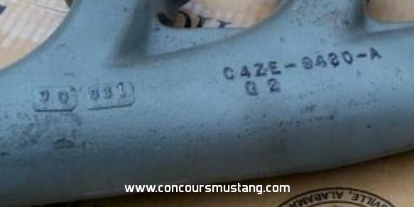

Here is an example of
a) The casting number (C3OE number)
b) A mold, vendor or factory ID number (N 3)
c) Date (when in the small rectangle it's usually of format [A-N]ddY (last digit) or B015 for February 01, 1965.) This date is sometimes upside down and looks like it was thrown into the mold.
d) The date is on the outside of the manifold and visible. After all these years it is not always readable.

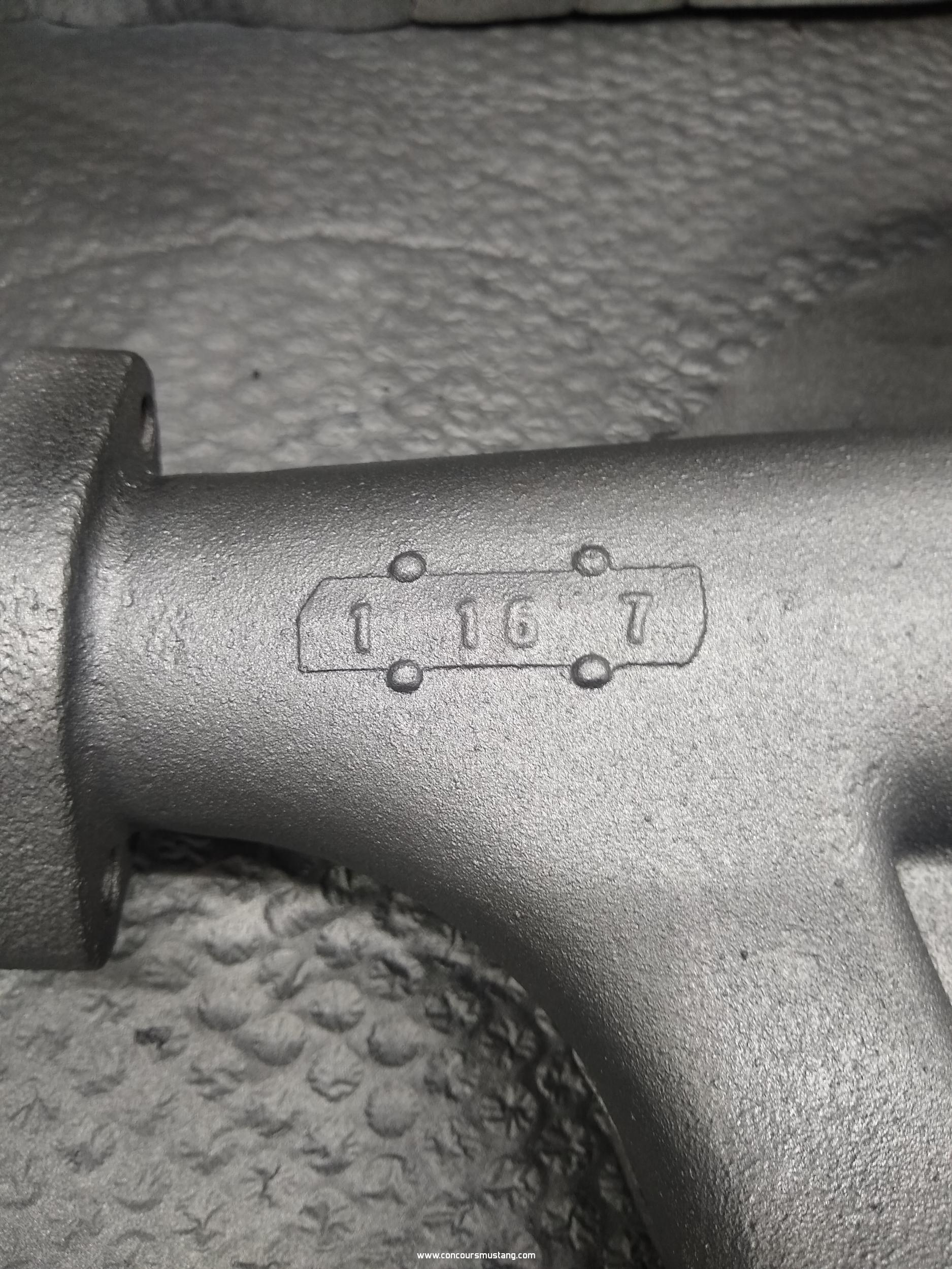

Sometime after 65 (this survey will help find out when) the date moved from the outside of the manifold to the inside. The format is md dd y, where month and day can be two letters but we think year is just the last number in the year.
Sometime around 66 another number appeared on some manifolds (far left in pic and looks like "128   06"). I've heard some say this is a date, but the syntax does not match dates and it may be a mold, vendor or factory ID. When you flip these manifolds over you should see the date with the 4 pins. Picture from MustangTek.

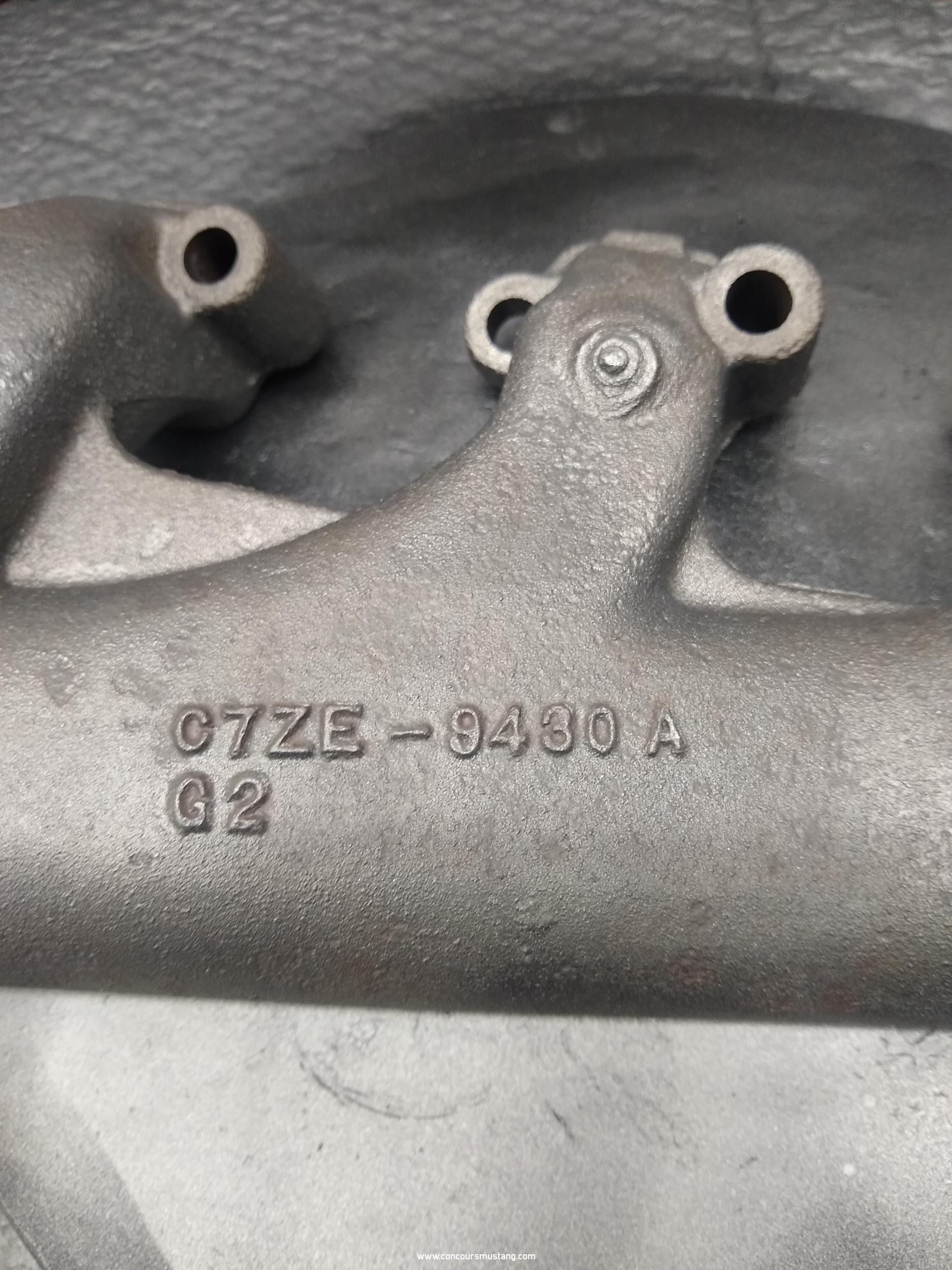

RH Outside Casting Number: C4ZE-9430-A
RH Mold Number: G2 (G is inside a raised circle)
RH Date: 2 16 6
RH Date Location: Inside
RH Other Notes: Inside front between first two ports has a raised square with dots in it

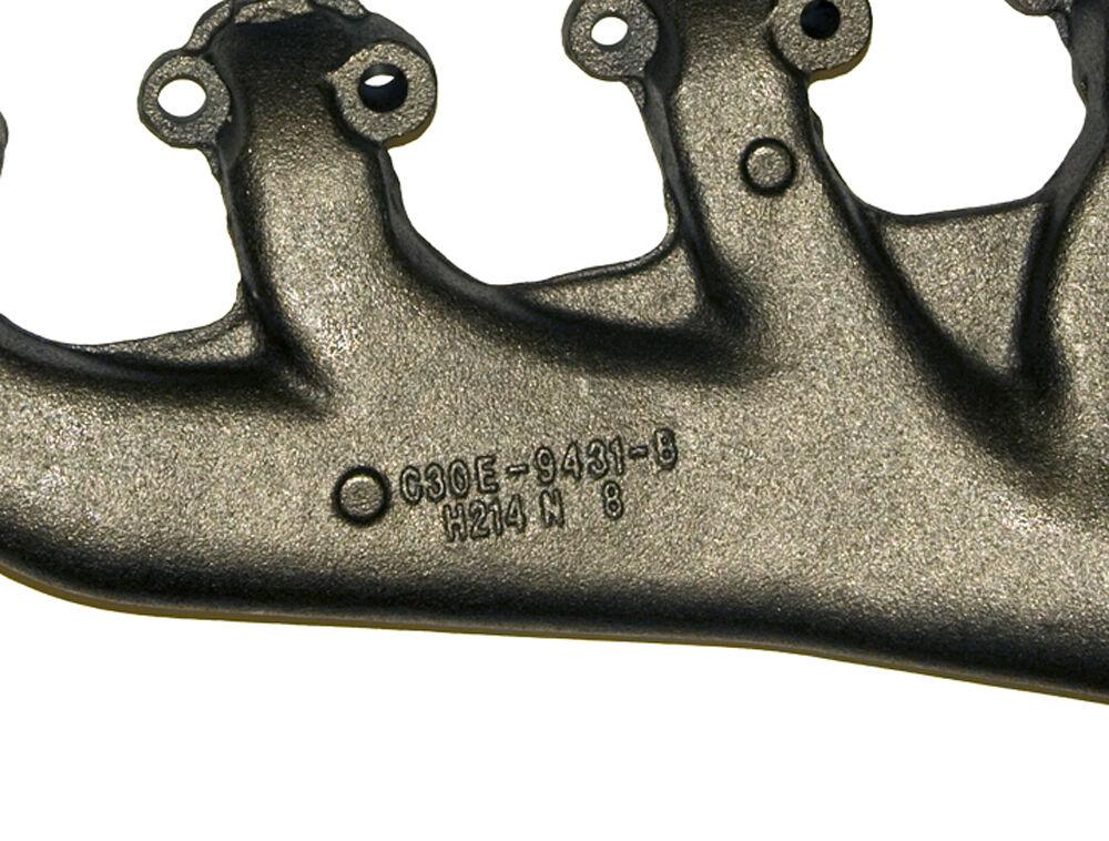

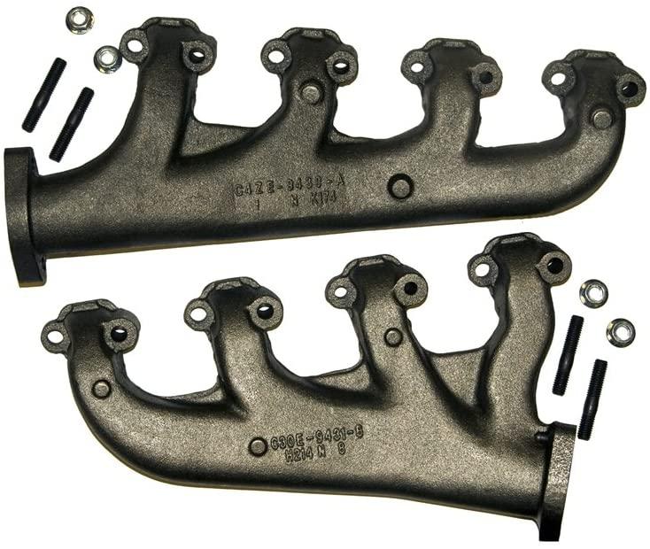

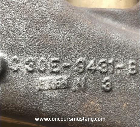

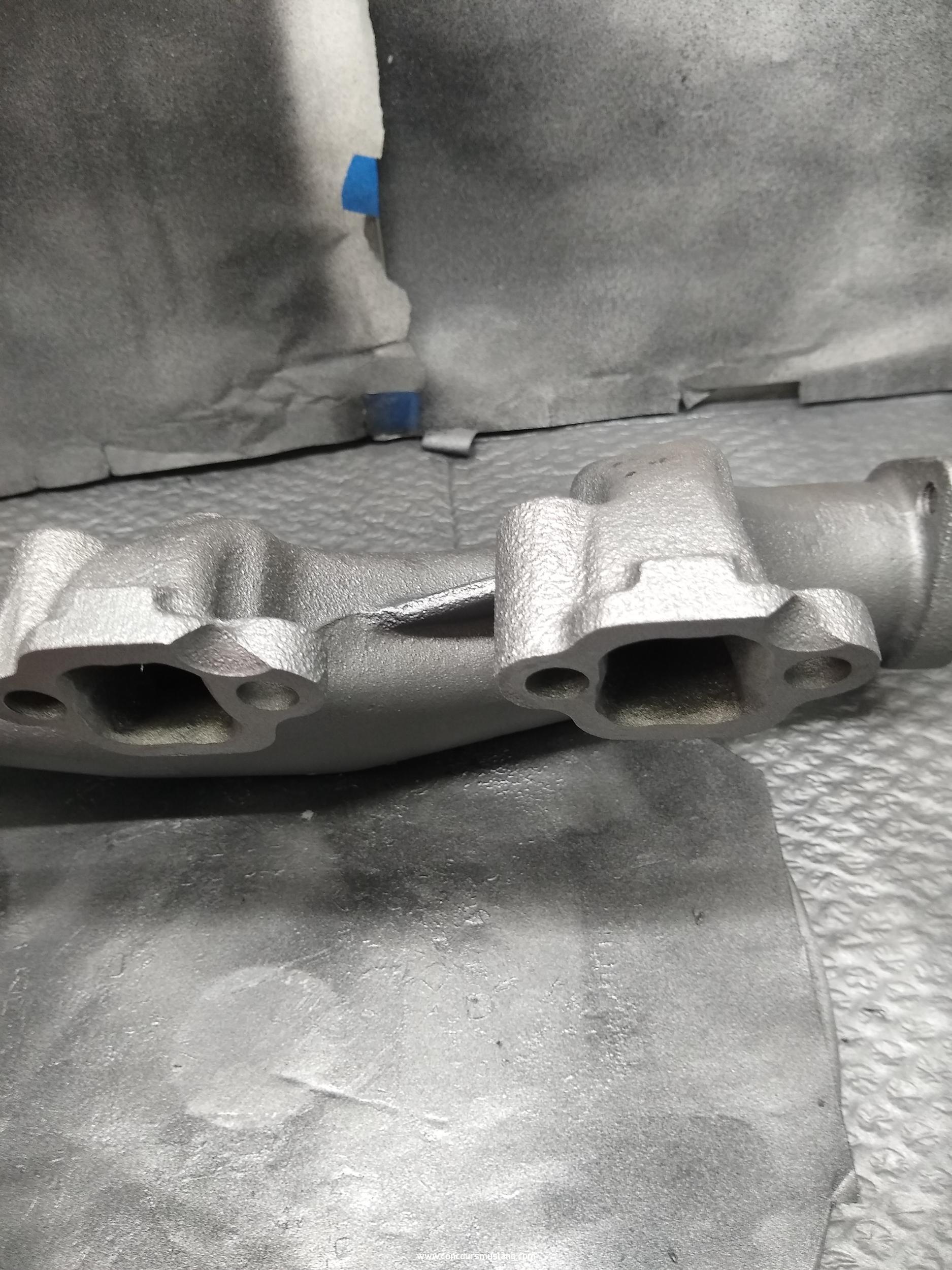

Getting good pics of the repops appears to be difficult as sellers usually want you to see areas that are similar, not different. Using the standard format I get this:
Your car's assembly date: N/A -- Repop
Are the manifolds original?: No. Scott Drake reproductions.
LH Outside Casting: C30E-9431-B
LH Mold Number: N 8
LH Date: H214
LH Date Location: Outer
LH Other Notes: N/A

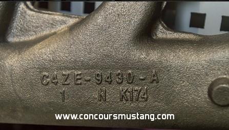

RH Mold Number: 1 N
RH Date: K174
RH Date Location: Outside

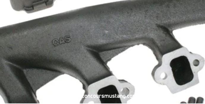

RH Other Notes: Backside has notation of "CAS"
Both manifolds:
C3:
C4:
C4 rear:
