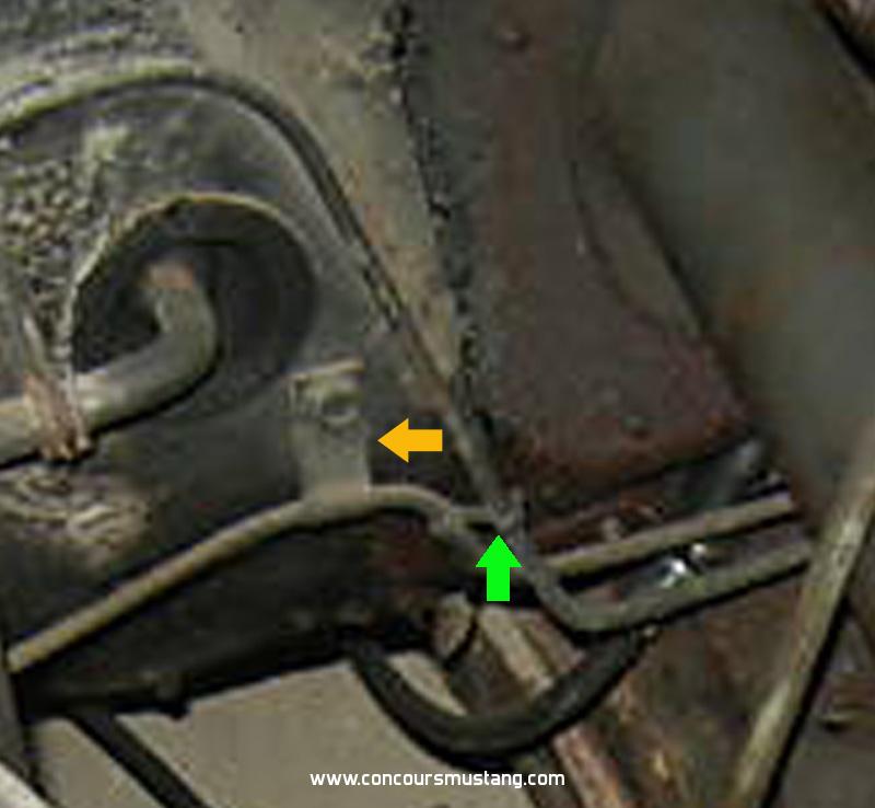

Something that came up during the survey was a possible difference between the clamps used to secure the rear brake line to the firewall near the steering column. In the first two San Jose pictures it appears that the same clamp was used in both applications just tilted depending on route.
In the two pictures below the length of at least the later version is much longer. Just mentioning it since its there - for discussion and to alert others to the possibility.
Also owners will want to make sure that they include the retainer placed between the two brake lines that is often removed or has fallen off over the years ( green arrow)
NOTE: These to examples also happen to be the latest above and the earliest below listed in my first post
