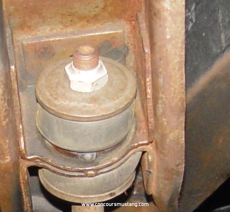

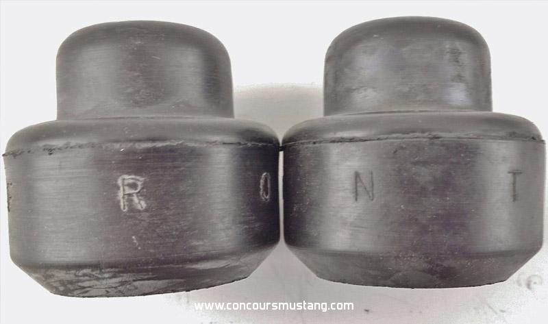

Thought I would add some pictures to this thread as an additional help
Showing part of the FRONT printed on each bushing.

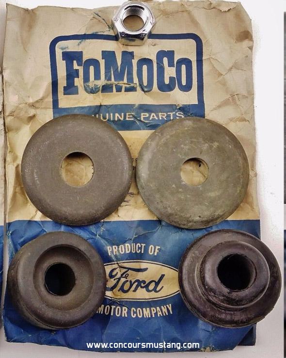

Original example showing the style of wash\her and retaining/adjusting nut
Picture an early NOS kit NOTE: As you can see the retaining/adjusting nut is different from the assembly line example above
