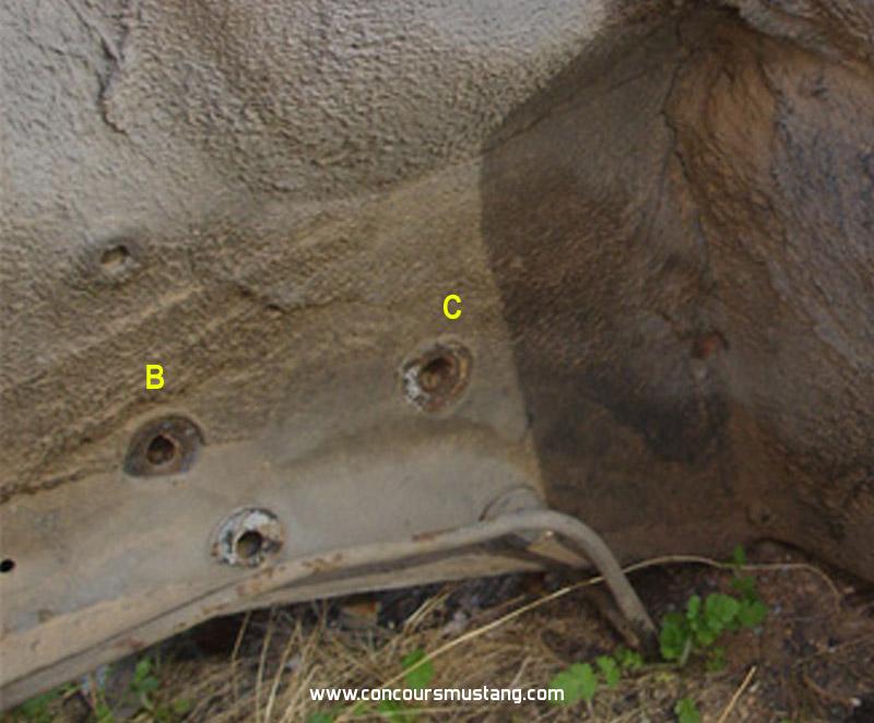

Rather than starting a new thread, I thought I might ask my questions in this thread.
From the Library, I found the frame measurement diagram and I have attached a portion of that diagram for my questions - thank you for making this available.
In the side view, measurements are provided for "B", steering gear mounting hole and "C", idler arm bracket hole.
Can anyone tell me which of the three (3) steering gear mounting holes "B" represents?
Can anyone tell me which of the two (2) idler arm bracket holes "C" represents?
Thank you in advance,
Mark

« Reply #11 on: January 08, 2021, 07:33:27 PM »
Mark can't be certain since it's not my drawing I did but would guess that the picture below might be correct. Would measure all three and if one is way off then it may be the wrong hole (b). Shame that they did not include in the drawing all three holes to cut down on the possible and apparent confusion
Hope this helps in some way
« Last Edit: January 08, 2021, 07:50:31 PM by J_Speegle »

« Reply #12 on: January 08, 2021, 07:40:32 PM »
Looking at the 69 diagram, 70 diagram & getting the tape measure out and looking at my car, on a fixture right now:
B = forward most "lower" steering box mounting hole, driver side
C = lower idler arm hole on the passenger side

« Reply #13 on: January 08, 2021, 07:48:27 PM »
Thanks that may help him. As suggested a measurement of both forward holes would likely tell the tale
