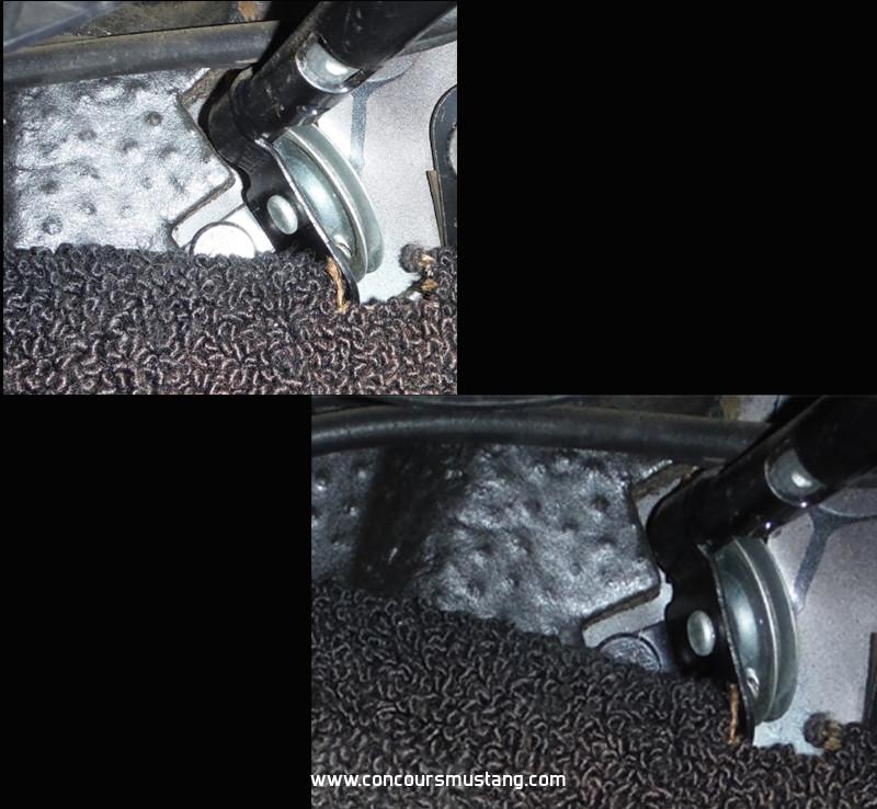

While we are on the topic of parking brakes parts and colors, I can't tell from this picture if it's the flash or a zinc part. I thought the whole parking brake tube and brackets were SG. Not the parts inside -- just the tube.
The part in question is the bracket and the large visible bolt (head) which goes through the firewall.

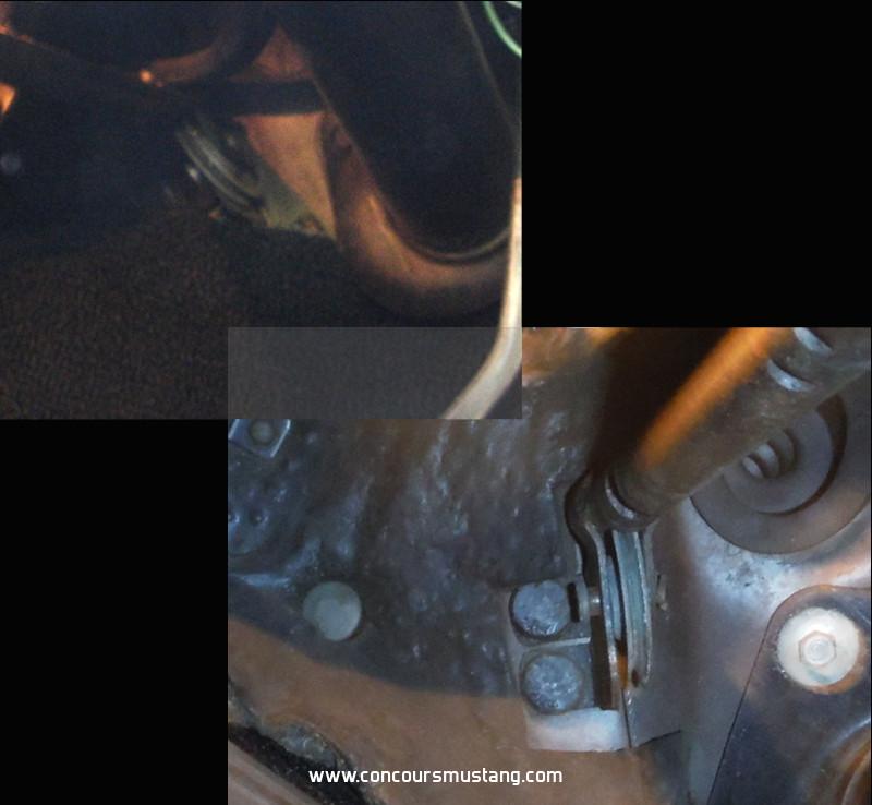

Recognize that picture - 7R02S2072xx. Let me deep dive into more examples to see if that is a flash/camera results or a true representation to help
The wider shot of that picture shows a close up of the firewall pad pattern that was being requested in the One build thread yesterday
Re: 67 parking brake component finishes
« Reply #13 on: March 08, 2021, 10:36:29 PM »
Good call. It appears that the finishes were squded due to the flash. I typically try to hand light rather than use the flash on the camera for that reason. Found another picture of the same area taken without the flash than day
A couple of pictures from other cars. Fair number of other cars had replacement carpet or carpet trimmed so the mounting hardware was not visible
As always hope this helps you and others
