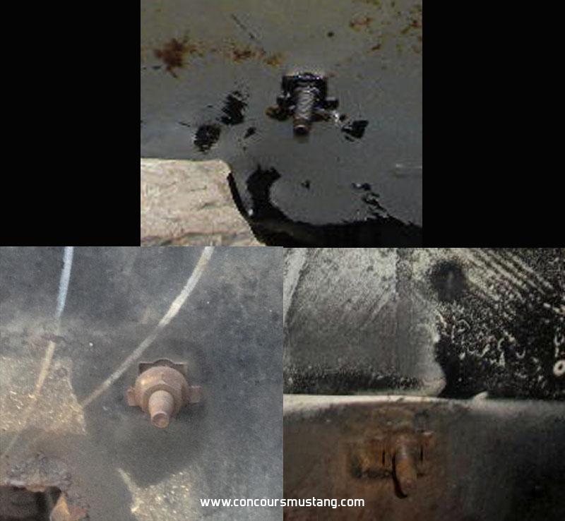

« Reply #2 on: March 25, 2021, 04:06:48 PM »
They are often removed when the owners/builders remove the front steel metal so the only examples I was able to find on my search were from 66 examples but it should give you an idea

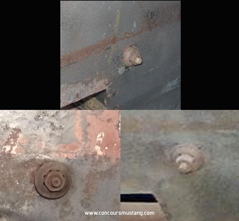

« Reply #9 on: March 27, 2021, 01:54:18 PM »
The correct nuts used for seat tracks are shown, but I'm at a loss as to what the pictures show is their application. It does not appear to be for the 64-66 stone deflector attachment.
  • Posts: 24861
Re: Upper Stone Guard Bolt Self-Retaining
« Reply #10 on: March 27, 2021, 03:01:30 PM »
Same location as shown in reply #2 In these examples the owners simply placed the nuts back on the stud after they removed the sheet metal - guessing they didn't want to loose the nut at the time
Notice the notch in the lower left of the sheet metal in two of the pictures that match the same feature in the passenger side radiator support. Sorry zoomed in allot to show the detail of the nut
« Reply #11 on: March 27, 2021, 06:51:09 PM »
OK, now it registers. The "seat track" type nut (378643-S2) was put back on the stud which protruded outside the engine compartment.
