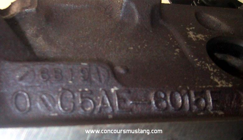

"""Ok, so I am now looking for a correct block and heads for my vehicle (have placed ad in WANTED section). I need to know what the correct block casting will be and the correct assembly stamping will be for a
May 20 built 66 A code GT.""""(QUOTE)
I have found a block, but would like your opinions of the numbers that are cast into this block  (see attachment/image) , is this a suitable block or can anyone see a problem with these casting dates etc matching up with my vehicles projected build date listed in the above  quote . cast date (6C16) and assembly date ( 6C18P)
thank you
Richard.  (I have this same post in the wanted section).
Sorry for any confusion.
« Last Edit: December 01, 2015, 06:23:46 PM by austr6 »

  • Posts: 5104
Re: A code 289 engine assembly code *** please help decipher***
« Reply #22 on: December 01, 2015, 06:14:54 PM »
I am reading March 16, 1966, final assembly date March 18, 1966. It fall within what has been explained previously as "acceptable" but, IMHO, maybe a ew weeks too early. I say this because it was only 2 days from casting to finished, supply (stock/inventory) was running out fast as they could build them.
That being said, if the bore and block are in good rebuildable condition, I PERSONALLY do not see any problem with using it anyways. The date spread seems to be acceptable to those judging these cars.

« Reply #23 on: December 09, 2015, 06:25:38 PM »
OK, what are your thoughts about the fact that this car was a special order paint vehicle...... would this effect the projected build date of may 20th 1966.  what I mean is would there have been a different period of time
or a longer period between the body being built and painted and the engine/ drive train  being installed and would this mean the dates would be greater or further varied ?
Thanks again for all your valuable information,
Richard.

  • Posts: 5104
« Reply #24 on: December 09, 2015, 06:36:10 PM »
Richard.
I think Jeff addressed the basic question before, I'm not an expert of time/timing on these cars (66 & older).
I gave only a personal opinion that I would probably use that engine since others also agree it is within reasonable range. (still not optimun, but OK at least)
Maybe others can answer the special paint question better.
