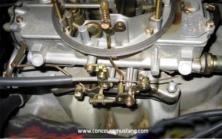

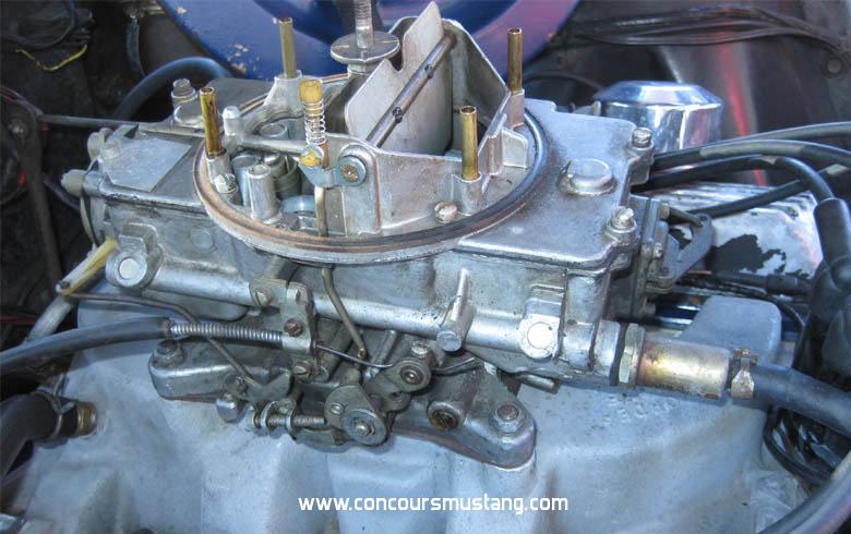

To illustrate
Top picture is more correct :) - lower one is prettier  ::) restored

To illustrate
I was wondering if the top carb in the pictured is a true HiPo carb? It doesn't appear to have the correct choke lever stop.

« Reply #7 on: December 12, 2015, 07:16:15 PM »

Dashpot is actually "peeking out" over the front bowl in Jeff's top picture. Take a look....
Think that is likely what generated the follow up question ;)
