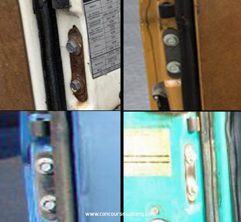

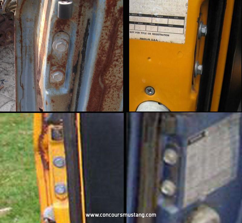

So took a look at the pictures I have where the finishes are visible. To start the plates IMHO were likely plated with possibly phosphate to protect against rusting by the supplier. This would also make a good base to paint over also. When I've found plates that were not painted body color they often appear (when not covered completely with rust) plated on one side and painted black on the other. Of course the worker could install them so that either surface was visible even though their was likely a finish that Ford wanted to be visible
In a survey of a small sampling its interesting that the cars with plates painted body color and those that were not formed a pattern suggesting the possibility of a running change on how Metuchen addressed the finish(s) on these plates
0T1125xx - Body Color
0T1129xx - Body Color
0T1127xx - Body Color
0T1210xx - Body Color
0T1245xx - Body Color
0T1263xx - Body Color
0T1285xx - Body Color
0T1292xx - Painted Black
0T1393xx - Rusty Finish but not Body color
0T1536xx - Dark Finish
0T1641xx - Dark/Black Finish
Earlier examples
Later examples
Retaining bolts throughout the year appear to be a zinc or cadmium finish

My car is 0T1190xx. Based on the consecutive build numbers you listed, my plates were likely body color.  I adjusted the height so some of the paint came off the bolts and it appears to be zinc plating underneath.
