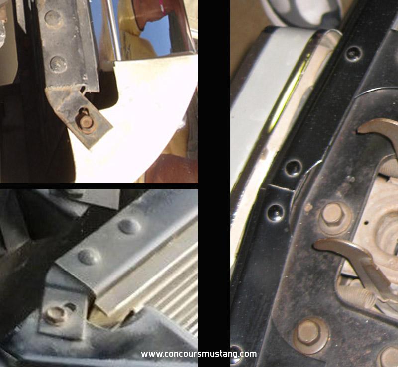

Hi guys,
Just wanting to confirm that the two top mounting brackets and the large central bracket were painted semi-gloss black as well or were they phosphate and oil like in '65?
Did you happen to look at some of the examples in the 66 Unrestored picture threads? Might have been a place to start. A couple of the examples have rusted grill top end tabs while others appear to still have their original finishes
Threads like the following have at least one picture each showing this area
- 66 San Jose T Code Thermactor Equipped Mustang (picture E1)
- Unrestored late 66 GT350 - Picture Thread (picture 1E)
Here are three pictures from Dearborn 66 unrestored examples
