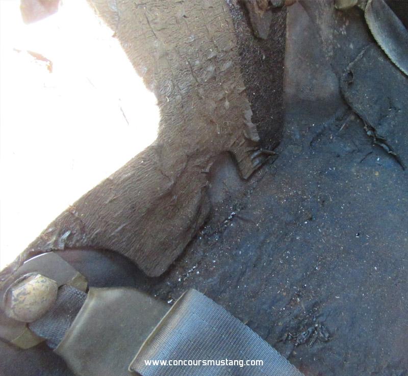

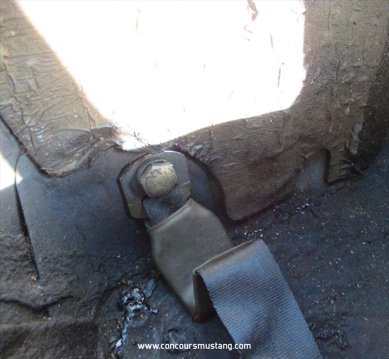

« Reply #3 on: November 09, 2021, 02:30:16 AM »
Sorry for the delay
Really difficult IMHO to determent in most examples if it was originally there or if it was removed or went to pieces over the years and trashed.
Not sure if the section over the rearend end (the floor section) receive a layer of underlayment on deluxe interiors and not standard ones.
Not sure if the application differs depending on when the car was built
I was able to find on unrestored deluxe interior from later in the year than your car and a San Jose car like yours
For your consideration. You can make out the underlayment panel that was installed under the rear set riser and the other one that laid over the rear floor section down to the seat one with cut outs for the seat belts and other details
Hope it helps in some way
