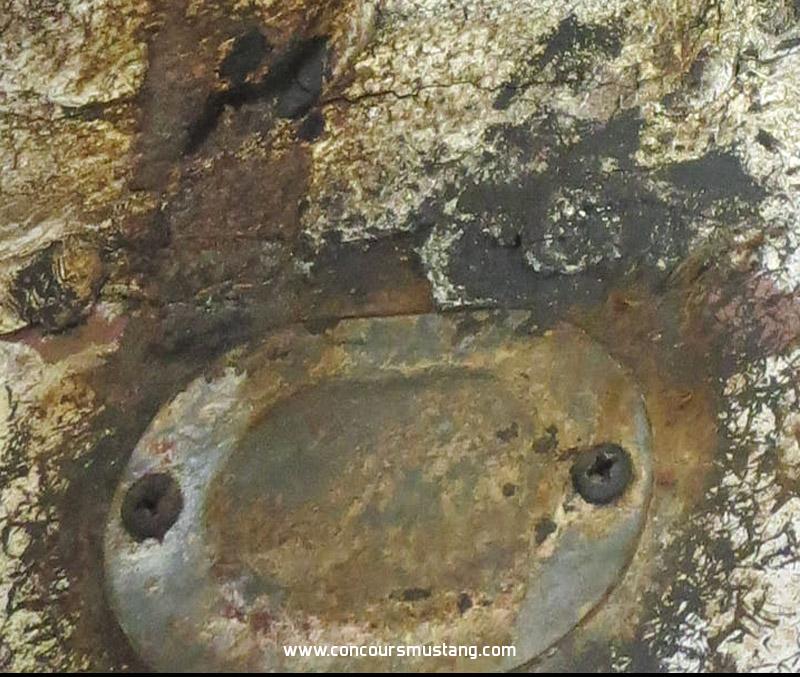

I apologize if I missed it in the past posts. I used the search query as well as looked in the unrestored picture area but the carpets were mostly in place. I also looked in the undercarriage finishes and sealer in the library. I am sure someone knows off the top of their head. What color are the four metal oval floor pan plates? Are they body color, black or plain metal? I would at least want to clear coat them if they are "bare" metal. Are they red oxide primer on the underside and body color in the interior if they were installed before paint? Thanks.

those have a galvanized finish.

They were not installed until well after the car painting steps were completed
Remember to installed a bead of black chalking on the edge of the opening before you reinstall the plates. if good to see some of this squeeze out from the bottom ones everything is tight
And remember they are installed with the "bump" up rather than down and in the floor pan opening

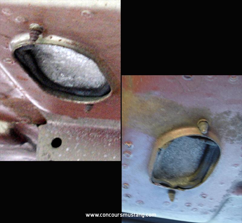

Along the same lines, I have seen/read people putting the "felt" side up and some the "felt" side down on the underlay. I just bought kits from NPD and if I am to go on how they are cut, the "rubber" side goes down. Yet when I took my original underlay off, it was "felt" side down and glued. I had to scrape the felt off of the floor pans. Is it "felt" down or up? Thanks.
IF the underlayment only has the tar and compressed layer on one side (different suppliers made it differently) Then for a 67 San Jose car would sometimes have compressed layer on both side but if I was choosing with a one paper side I would put that facing upward based on the thousand or more I've found. The large thick layer can be found to be jute or a dark (as you call it felt) product. The "tar ;ayer, can heat up and or the oils can flow from that layer to the thicker layer over the years compressing and compacting it.
Here is a couple of pictures to illustrate what originals look like and are laid on the floor section

The NPD kits then are glued to the wrong side if the tar/rubber side is up and the jute side is down. I will have to un-glue the jute and rubber layers and re-glue them so that the holes are right and the jute is facing down.
Or if you want to correct them you could choose to add another layer of the tar/comprssed layer over the exposed jute surface like some versions.
That is how I made the last ones I did and shown in that article in the Library. Of course not everyone cares about this unseen area, as long as when ever you use is still thick enough to make things fit right, but some do
