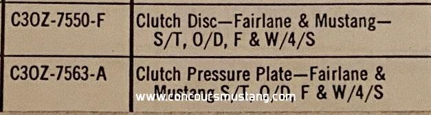

Ford Motor Company provided a detailed parts list for 1963-65 vehicles factory equipped with 289 High Performance  engines to dealers for the 1965 model year.  The document had subsections for "WHEELS AND BRAKES", "FRONT SUSPENSION - STEERING - REAR AXLE", "FRONT SPRING AND STABILIZER", "REAR SPRING", "ENGINE ASSEMBLY", "ENGINE COMPONENTS", "TRANSMISSION - CLUTCH", "FUEL SYSTEM", "GENERATOR, STARTER, DISTRIBUTOR", "SPEEDOMETER", and "SHOCK ACCESSORIES". I refer to the engine and clutch components tables occasionally which brings us to the clutch pressure plate; I will touch on flywheel ring gears also.

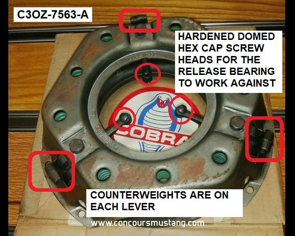

289 High Performance engines were equipped with a heavy duty pressure plate assembly. Ford could have installed pressure plate assemblies with very strong springs to reduce clutch slip for competition use, instead they chose moderately strong springs and built in counterweights to let centrifugal force make the pressure plate grip stronger as engine rpm went up. The general design belongs to the Long Style of clutch pressure plate assemblies.  The original 289 High Performance assembly is a very robust version of the Long Style with features the common replacement assemblies will not have.  Factory identification wise assembly line and service covers were marked with BRONZE paint and the springs were dip painted GREEN under assembly number C3OZ-7563-A.
This is the exact same model pressure plate used in new street and factory team road race Cobras the world over 1963-1965. Ford Motor Company and Shelby American, Inc. both sold them as high performance and race units over the counter.  I have used them in Cobras and a 1965 MUSTANG GT350 without any issues street and road race track use, cruising in traffic or shifting gears as high as 8,500 rpm (balanced with engine of course) no problems.
