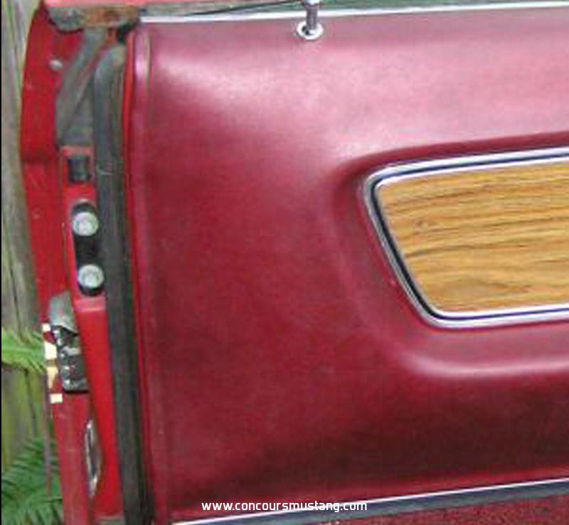

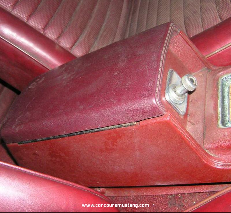

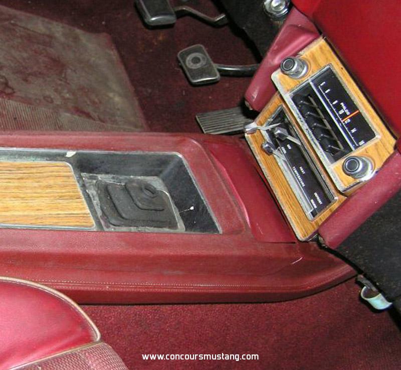

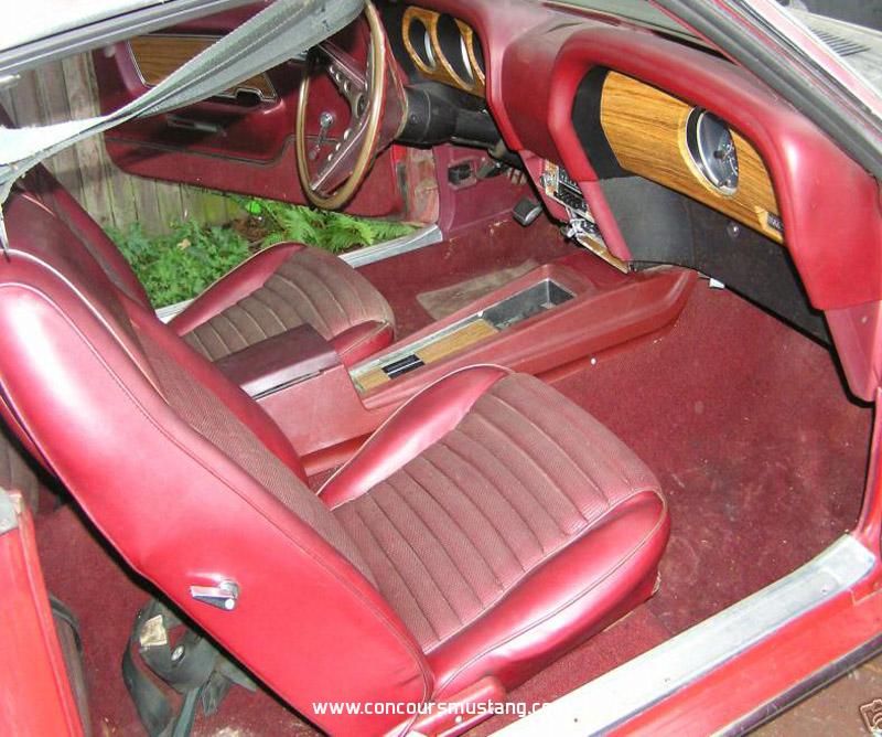

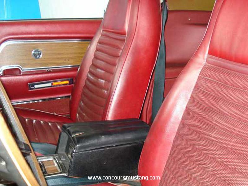

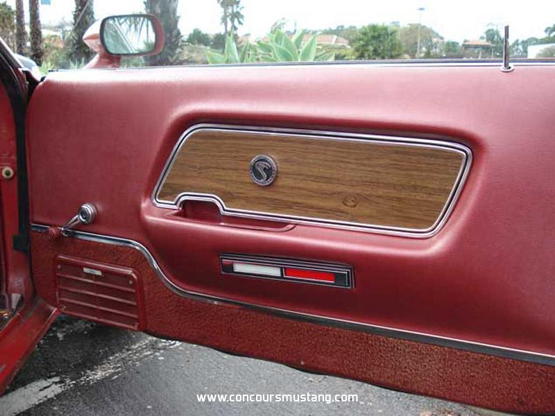

The vinyl used originally often had, I guess, could be called a "metallic" or "metal" look to the color/finish. The red was not a true fire engine red or something like that strong deep color. Some might describe the color as having a slightly purplish look to it in some conditions.
Of course the true colors are often not represented in pictures but going to post a few in hopes that others can get a general idea of the factory look from unrestored examples For the first three examples I stayed with 69 San Jose as your car is.
Early example
9R13000's This one if of course much different in that the surfaces have not been cleaned so the "true" colors are off but we can still get a general look and compare the painted to the padded as well as vinyl finishes
9R15000's
And a couple from Dearborn In this one the difference between natural light and flash/additional lighting really stands out
