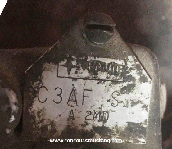

I believe the carb tag should be FoMoCo not Autolite.
In my experiences Ford 2100/4100 carburetors mid 1962 into at least mid 1966 by date, and perhaps longer:
Carburetors sent to the engine assembly plant had tags marked with FoMoCo(R) logos.
Carburetors used in service departments or sold over the counter could have either the FoMoCo call out or some version of AUTOLITE(R) logo.
I have seen both FoMoCo and AUTOLITE tags as reproductions. I friend ordered a replacement tag for his 1964 carburetor and was sent one stamped AUTOLITE which was not correct assembly line wise.

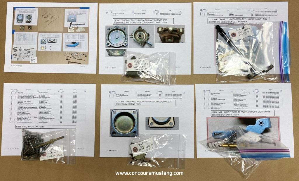

Be aware that many of the parts with a dichromate conversion coating (anything yellow gold so to speak) in the offered unit are much darker in color than the typical new Ford carburetor in period. The typical Ford 2100/4100 might have dichromated parts to as few as three to as many as six or more shades. Some small parts were just bright zinc originally or leached clear dichromated zinc. Earlier this year I separated parts for a single carburetor into several different levels of refinishing and they were refinished to match in batches. Because I had to send parts out to be custom refinished I made spreadsheets with color pictures of what colors levels I was after to go along with the parts.
Extra time and costs. It is much lower costs for rebuilders to finish all parts the same without regard to how typical parts were done by suppliers in the 1960s. No, finishes did not stay constant for years at a time or even batch to batch. If assembly line like appearance does not matter to a buyer so be it. If the buyer wants to take what they obtained and get it as close as possible to day one appearances all over, considerable additional time and expense can be involved.
Despite sellers of goods and services might say, most commercial work is more of set of practices to remanufacture something and not return it to as close as possible to day one specifications and norms in every way. Remanufacturing might be possible within a few hours while getting every part and finish as close as possible might take a week.
