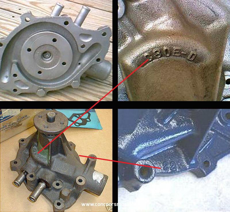

I have a June 27th 1969 Boss 302 build. Were the 1969 B2 Water Pumps date coded? If so, what casting numbers and date codes should I be looking for? I see there are different types of water pumps on eBay with the same casting number C8OE-D. Some have date codes and others do not.

I think the correct number for a 69 is a C8OE-D. There again, not specific for a boss except for the 6 vein rotor.
Not too sure about the date codes.
See if this helps, and you can always call Jack Brooks at Dead Nuts On too.
https://www.deadnutson.com/1969-boss-302-water-pump-rebuild-service-return-shipping/

Agree that the part carried the C8OE-D engineering number on the tip of the pump behind the pulley flange. No date codes it appears only a possible cast number.
As mentioned the main body is somewhat generic and shared with allot of other engines - just the impeller difference
