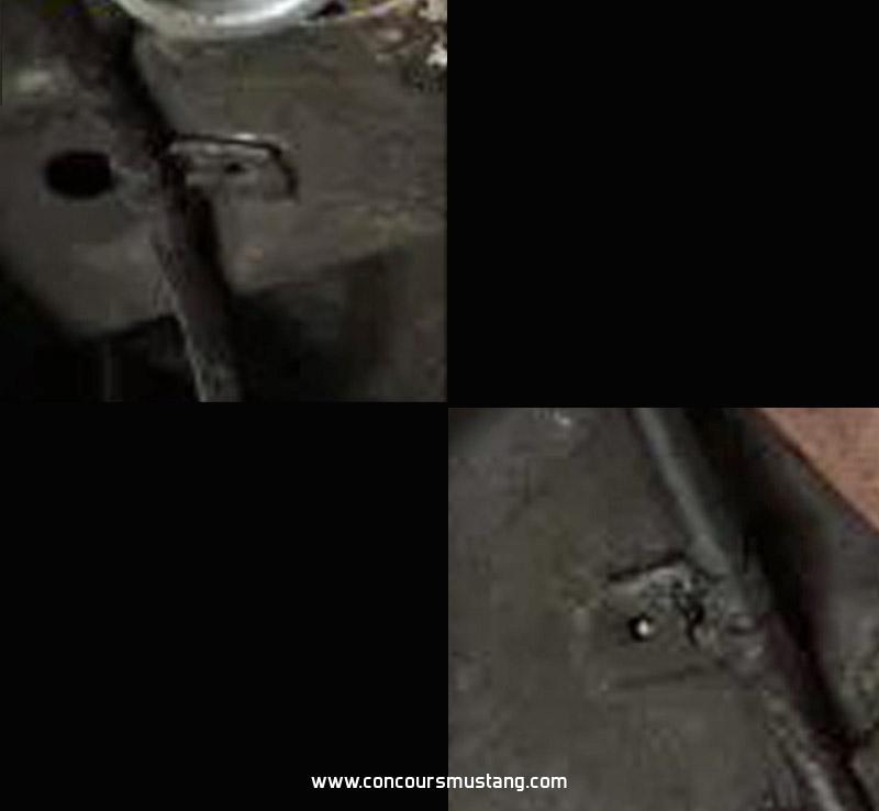

Travels down the drivers side of the front frame, transmission tunnel, across the cross member above the rear of the trans and then into the rear transmission housing
At the frame rail
Dirt and greasy picture but here is one for the cross member
