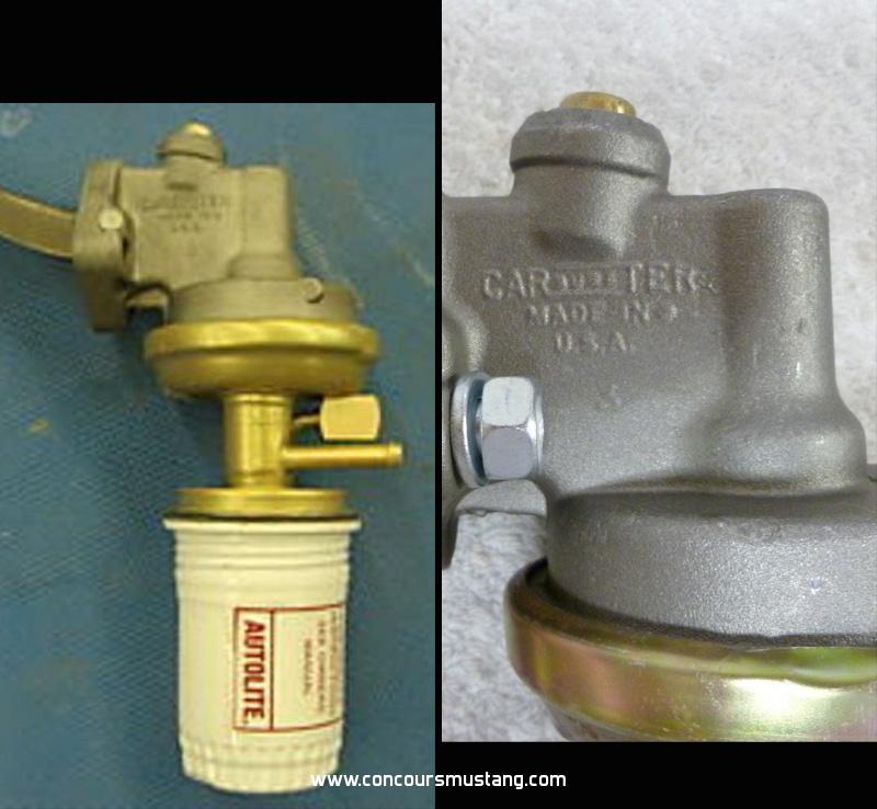

Jeff, that is the correct style of pump and canister however the assemblyline GT500 pump typical was trademarked CAR bure TER and not Carter. It is hard to tell but the picture pump my have a 3/8 inlet instead of 5/16 like original.

Agreed - hard to see in this picture (low resolution) but given the box it came in (if it is the original to the pump) then one much expect it to be the earlier CARbureTer
Little clear example and a close up

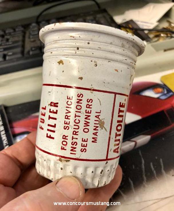

Along with a close up of an original canister

The Autolite marked fuel canisters are the hardest to find of the various fuel canisters from my experience . I think that they were one year only and then strangely Ford went back to FOMOCO as those are the ones I find in later boxes. I recognize the background of my computer and GT40 mouse pad in the picture of the original filter canister.

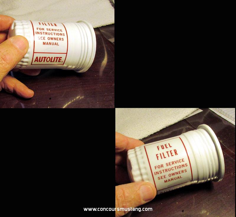

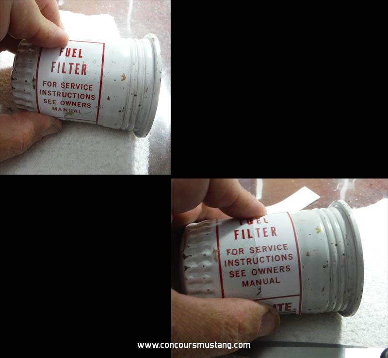

Need to get with a printer to get these done and available (NOT AN ADVERTISEMENT) rather doing them the current way. Know you've seen the results but for others here is some more inspiration as to what can be done with a little thought and craftiness. Not 100% perfect in their current finished form but pretty good if I do say
Couple of shots of testing the art work
A finished canister - it has a flaw so it sits on the shelf because it that

I'm working on my fuel pump right now.   I noticed in one picture the the "Autolite"  the "A" in autolite is high, closer to the pump and the other picture the "A" in autolite is closer to the ground.   Which is correct?   Also, is the pump itself natural, unpainted?   The one you made has the "A" closer to the ground.

fuel pumps were added after engine assembly therefore all are always unpainted.
Both. Not unusual (looking at many different stampings and sticker) for workers to get int he habit of placing the stickers they made or stamps they applied at certain angles or even locations from other workers and inspectors didn't seem to mind as long as they got applied, were visible and most often in the suggested area. Might in some cases, even be related to left or right handed, the worker working the silk screening operation that day or shift
Pump has a natural main body and arm with plated sections and fittings
The one I made can be applied to the can in either direction when the design is applied
