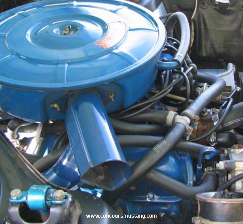

Looking for information on correct routing of heater hoses on 67 289 A/C thermactor.
I searched through several posts and knocked on the proverbial door a few times, but I'm left needing more.
From this post (http://www.concoursmustang.com/forum/index.php?topic=10157.0) there is a picture that I've highlighted and attached here.
Realizing of course that it is a Dearborn non-thermactor car, but it is the closest thing I've found.
I have three questions:
1. On the supply hose I see that the carb choke spring (yellow box) has the bracket to contain the hose, but the hose appears to have been pulled out.  Should the hose run through it?  If so, would it continue over or under the PCV hose on its way to the heater shut off valve?
2. On the return hose, as indicated by the yellow arrows appears to be items that look like clamps.  Looking again, I see what could be two small vacuum lines or wires, and what looks like clamps could be electrical tape to connect these items together.   If there were no clamps, what keeps the hose from moving and touching the exhaust manifold?
3. Any idea how the routing was influenced by thermactor?  I suppose that the return hose would need to work its way around the air pump.  Any pictures?
The second picture is from the MPC illustrations book.  It does not depict a hose running along the face of the choke spring.
Thanks, John

I have a file that has pictures of Pete Morgan's 67 GTA 289 /W AC and Thermactor.  I do not want to post them with out his permission. Hopefully he will be a long. Is you car a 2V or a 4V?
 Here is a picture of our 67 GTA 2V with AC with out thermactor
Re: 67 heater hose routing 289 A/C thermactor

Attached is a pic taken from the 1967 Ford Preliminary Shop Manual, showing a drawing with the heater hose routing for non-Thermactor 289.
As we know, it gets crowded in there when the Thermactor hoses and AC hoses are layered on top of everything else.  Don't know if it's completely correct, however on my AC Thermactor car (C-code) with the ignition coil mounted on the intake manifold between the right valve cover and the carburetor:
1) I've kept the heater hose routing consistent with the drawing, with the return hose from the heater core routed over the PCV hose, through the choke bracket and to the forward nipple on the water pump.  Passing under the PCV hose is the Thermactor hose that is routed aft from the tee to the air gulp valve at the rear of the intake manifold.
2) The heater core inlet hose from the intake manifold nipple to the hot water valve on the cowl (AC car) is kept away from the exhaust manifold by routing outboard, between the air cleaner heat shield and the inner right shock tower.
3) I can try to send a pic for how it looks on my car.
Here is an item from six months ago on the forum, about a 66 Thermactor car.  Which is one of the reasons I've kept the heater hose routing consistent since there's not much difference between 66 and 67 Thermactor systems:  http://www.concoursmustang.com/forum/index.php?topic=15982.0

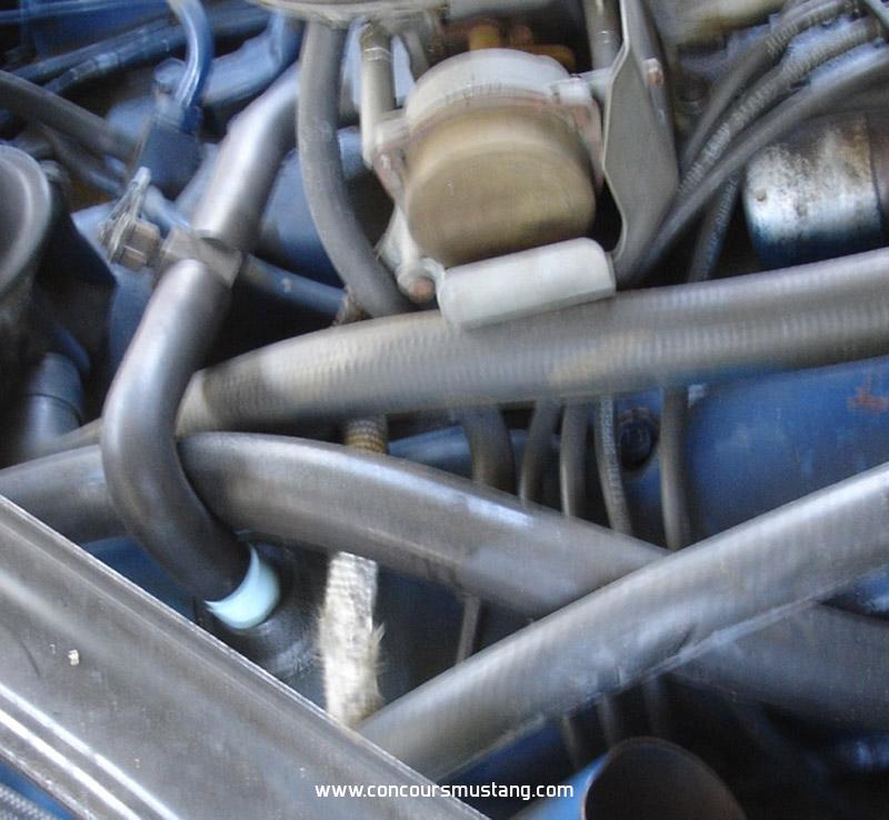

Don't believe the coil placement was any big challenge since everything passes over it though getting to it later to service was not as easy as a non-thermactor car. You can make out the coil in picture #1 and #3 pictures below
Also the "valley" between the passenger side valve cover and the intake/carb gets really busy/full when you consider that the thermactor hose from the T to the valve at the back of the intake runs along there also

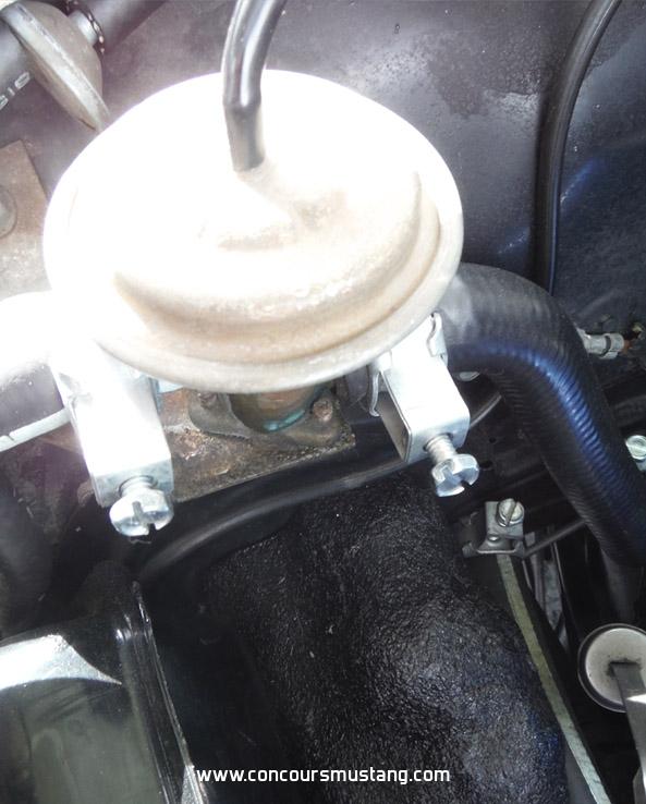

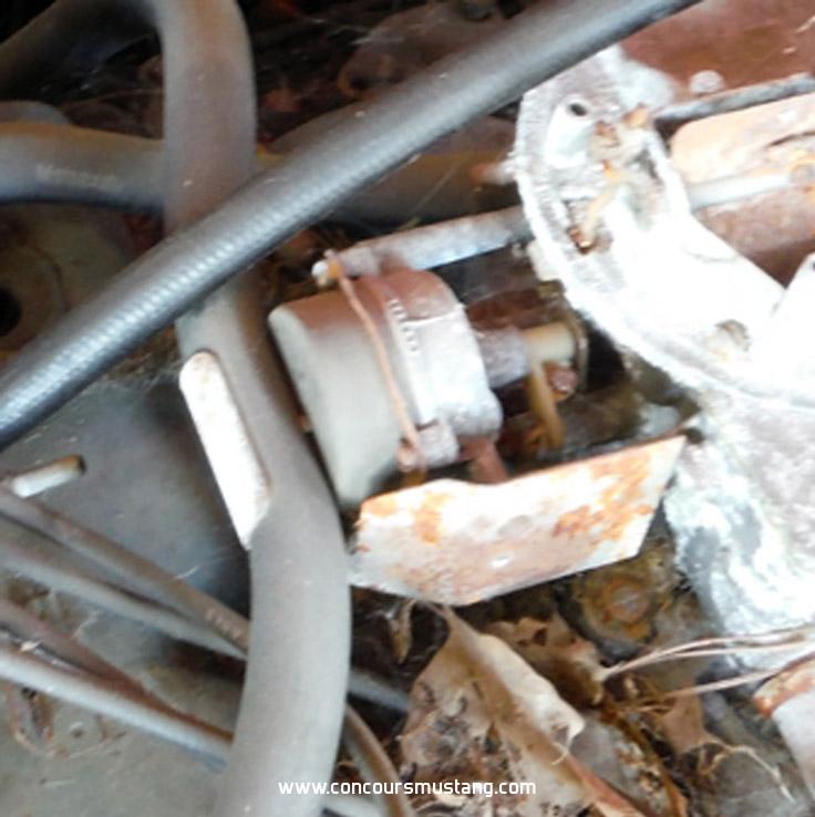

Here are a few supporting pictures showing the heater hose retainers and related parts. Some of these pictures are from the Unrestored Picture section and were  not posted when this discussion first started. Will include shortened  VINs for reference
7R03C1883xxx Heater hose had been replaced though it most certainly ran through the carb bracket
7R02C1721xxx Heater hose still positioned in holder
7R01C1824xx Unfortunately air cleaner still in place though the hose appears to be heading towards the carb bracket
7R01C1977xx Heater hose shut off valve
Of course have a fair number of examples to post more if needed depending on what details are needed. Unfortunately fair number have air cleaners in the way of some details
