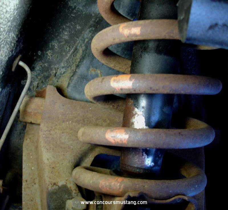

Coil Spring Markings For GT 500 4spd no AC or Smog
« Reply #9 on: August 21, 2022, 09:09:01 PM »
The car I'm working on had two different front coil springs with different markings and the NOS set i got had even different colors. It is car #1354 gt500 4 spd, no AC, smog.  One spring that was on the car had gold, blue, and one white.  the NOS set had two blue stripes.  Any help would be greatly appreciated.

As we've discussed before in other threads the presence of a white spray stripe indicates that the coil spring did not test within the predetermined minimum necessary for that particular springs specifications. So as as not to waste it and the car not have issues with the way it drove and felt these marked springs were paired up on the line with another with the white stripes and then were installed as a pair on the same car. For the service replacements do you have the part number assigned to them.
I've never seen blue being used on front coil springs for our applications in 67 and unfortunately Ford MPC's don't list springs for 67 Shelby's  :( But of course if they did we would have to wonder if what they listed was the original springs or simply approved replacements.
- Can share that I do have a car built with just a 4 speed, no AC or Therm, a few weeks before your car that had evidence of a gold  & tan stripes but not a blue stripe.
- On a car 67 GT500 speed with no AC or Thermactor built about 400 cars after yours I have the pictures below if it's strip below
