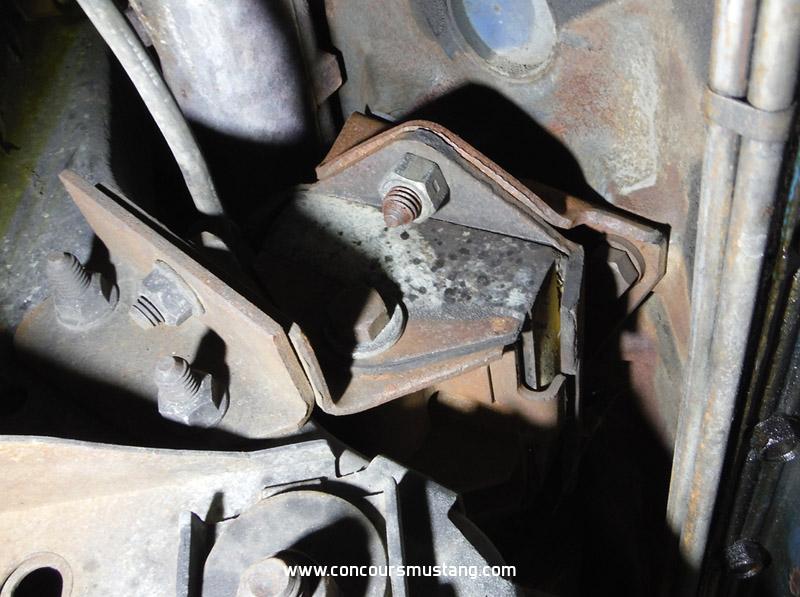

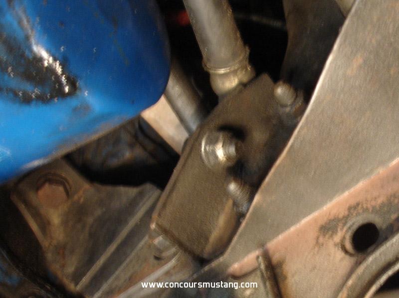

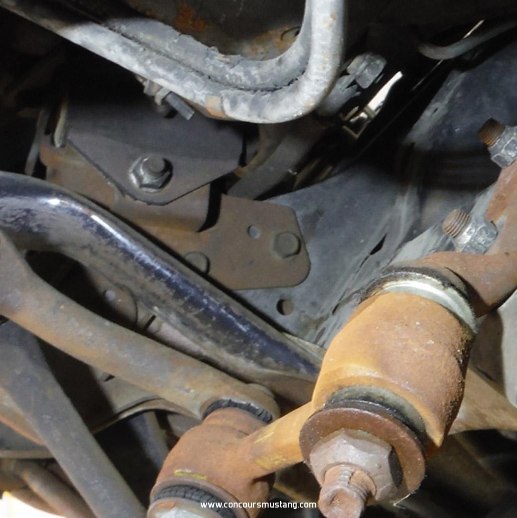

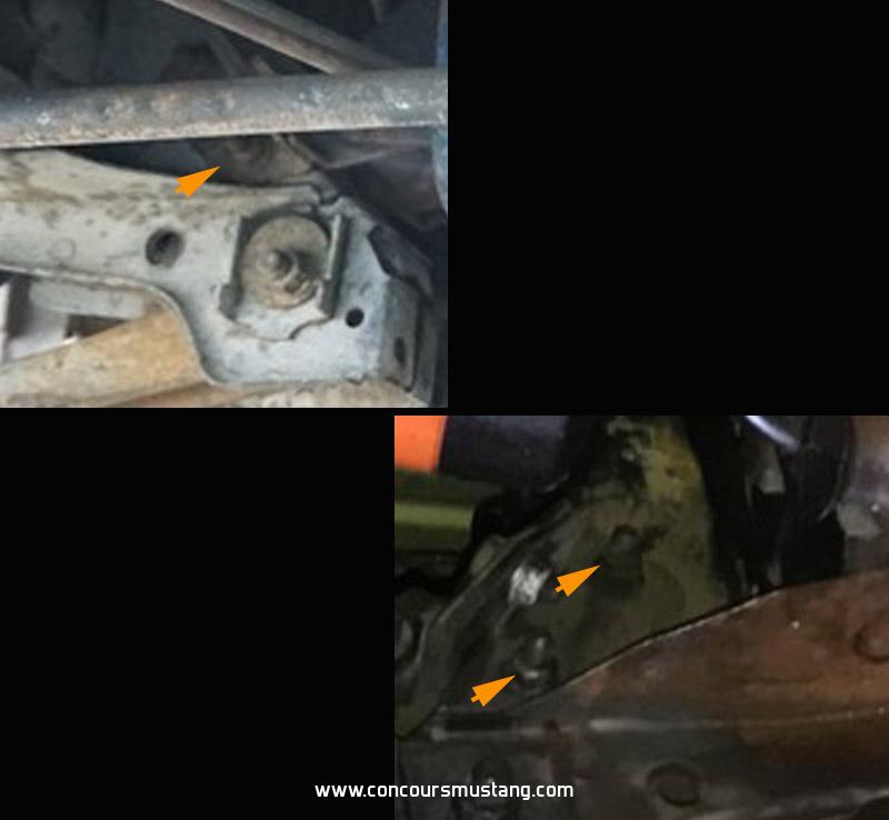

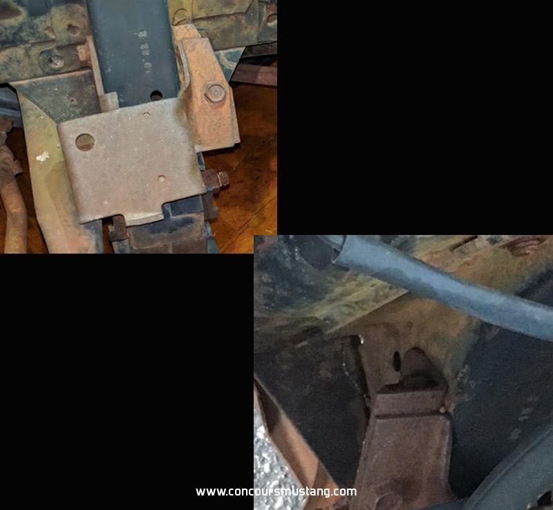

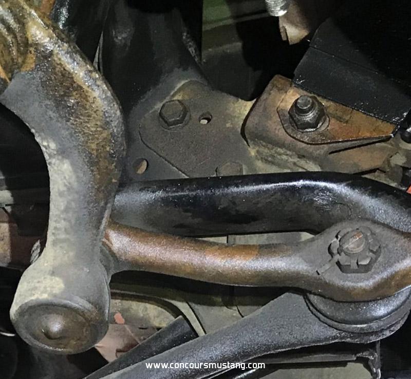

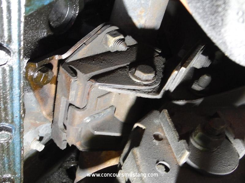

Question came up on another site were someone was looking for the direction the bolts that attached the metal motor mount brackets to shock towers were install. Posted a number of pictures and in turn the answer so felt I should post them here also
Pictures cover from 7R110xxx through approx 7R207xxx. Some are the same as shown in a couple fo the 67 Unrestored Picture Threads in that section of the site. Hope these help answer some questions other have now and in the future
As shown the bolts are inserted from the rear and nuts are attached to the front side - towards the sway bar and front end of the car
