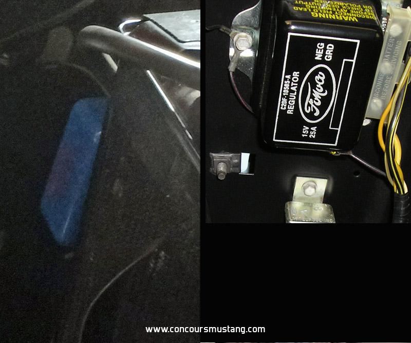

- Voltage regular or at least the cover is finished unlike originally done.

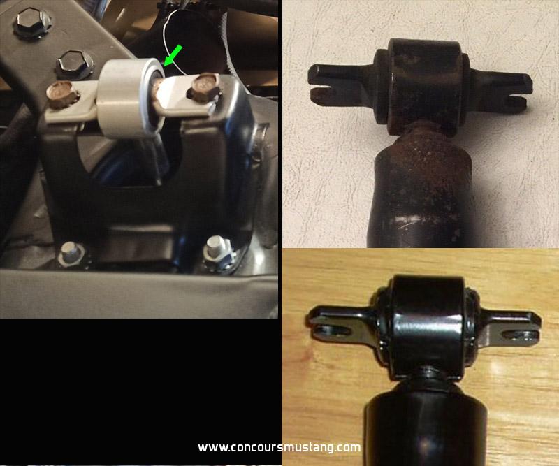

  They are natural finish, shocks bolts a bit rusty, should they all be phosphate & oil?
- Easy one would be the front shocks are not finished correctly
  Do you mean shocks color?
  I read in threads that it was the correct 64 one (blue print/yellow print/black case)? Am I wrong?

- Are those bolts for the shock and spring covers painted? If so those should not be
Fender and inner fender (spring and shock cover) bolts would all have been P& O
Yes that is the easy part though the visible, from this view, part is different from originals. The upper eye is shaped differently to apparently hold the smaller bushing in place and then the bushing itself. Originals do not have that beveled edge around the bushing as shown on yours. Comparison of bushing size below

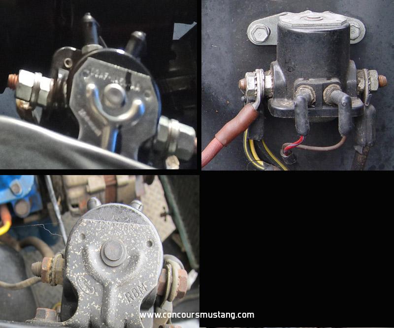

- You already made mention of the hose clamps (radiator and heater hoses) fan belt, solenoid,  and other items that are not like originals
  Should solenoid be the brown one? I read sometime brown, sometime black
No black is find its that you have one marked Motorcraft with a 1972 engineering number and the hardware at the posts is different from original. Like above yours in in the upper left

- Hood hinges, springs and retaining bolts appear to be painted black
  I thought it was 64 correct - Thought P&O was in 65 or 66
Your correct - Sorry for my mistake of not remembering when the change took place
Generator equipped cars have never really been a focus for me and the location of this item isn't one that we get allot of pictures of. With that said maybe someone familiar with the voltage regular will post and confirm the details. Looking through my pictures I was only able to locate a restored car with the yellow face printing which may indicate the heavy duty version of the regular while the example in the picture below (your left theirs to the right) which was built and owned by one of our founding members
Hope this all helps
