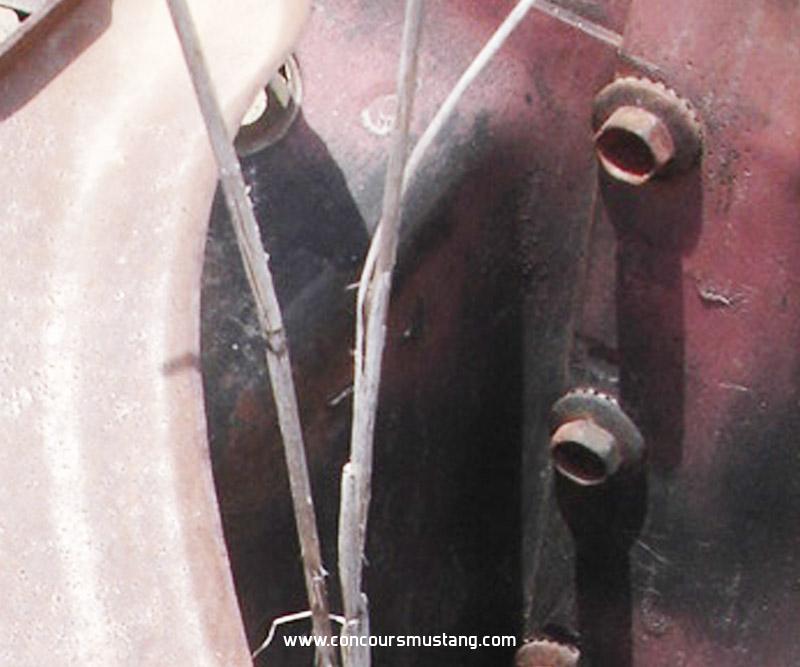

« Reply #2 on: December 06, 2022, 03:07:04 PM »
I cannot guarantee these are original, but they were on my Mach 1 in 1993. At that time I replaced them thinking they were not original because they didn't match my prior 69 mustang. I now believe they maybe original and reinstalled them. Glad I didn't toss them in trash. Mr. Speegle and Mr. Gaines your comments please. San Jose, 11G build date. 9R02H1895XX
  • Posts: 24919
Re: 69 San Jose - Spring/Shock Tower Cover Hardware
« Reply #3 on: December 06, 2022, 03:34:27 PM »
I cannot guarantee these are original, but they were on my Mach 1 in 1993. At that time I replaced them thinking they were not original because they didn't match my prior 69 mustang. I now believe they maybe original and reinstalled them. Glad I didn't toss them in trash. Mr. Speegle and Mr. Gaines your comments please.....
Have seen those flat headed RBG used on Dearborn cars during specific periods but don't recall ever seeing them on a San Jose. Hopefully a look at later originals cars will tell us more.
BTW is your car restored and do you know if it was restored in the East?  Would not be the first time a San Jose car picked up some Dearborn details when that takes place. Happened allot of early Shelby's for example
Late car. Going through my pictures collecting ones to post I do see a pattern that does not include the bolts you have pictured. BTW are the fenders held to the body with the same types of bolts presently?   Just guessing :) Since that would confirm what I suggested above IMHO
« Last Edit: December 06, 2022, 05:03:59 PM by J_Speegle »

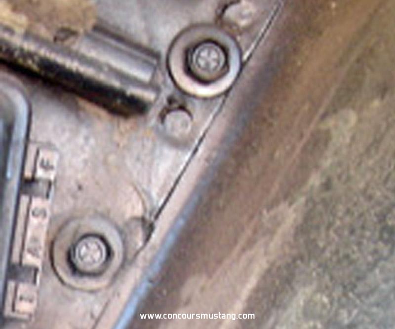

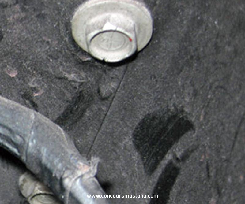

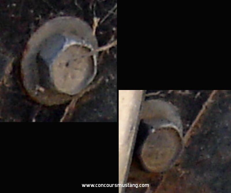

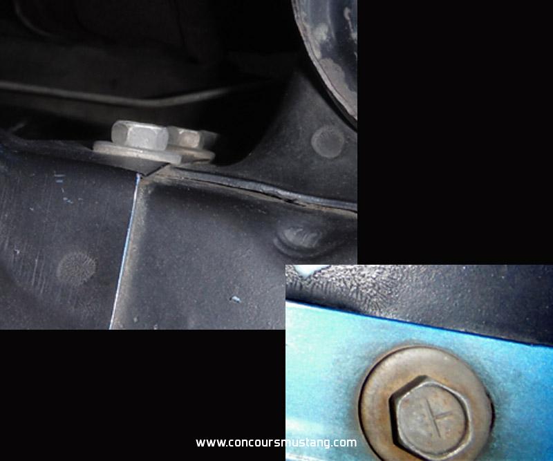

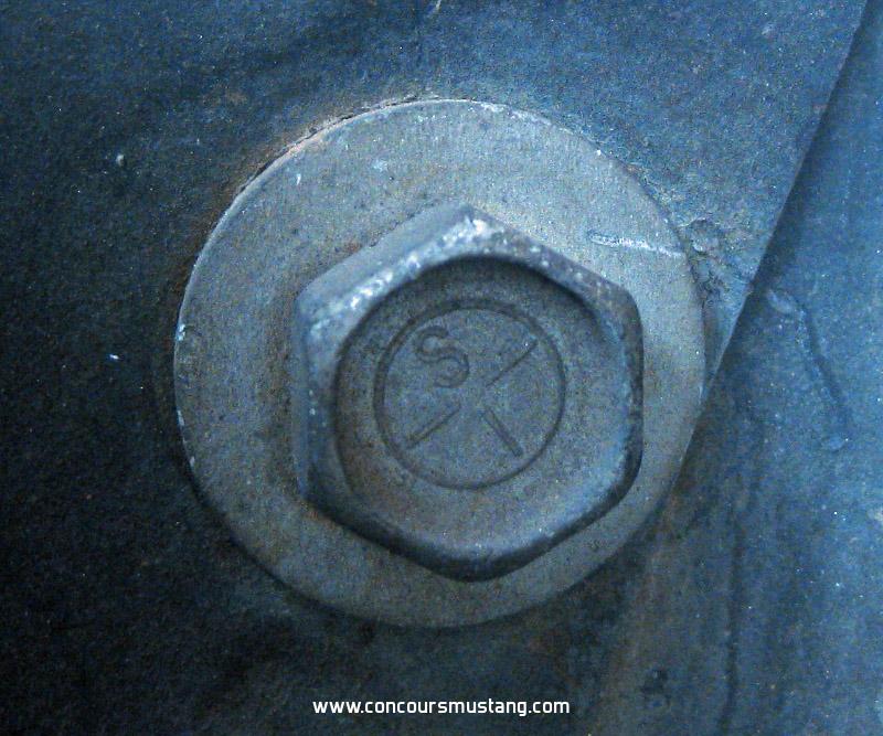

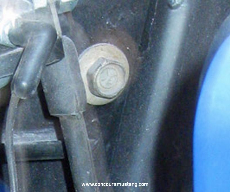

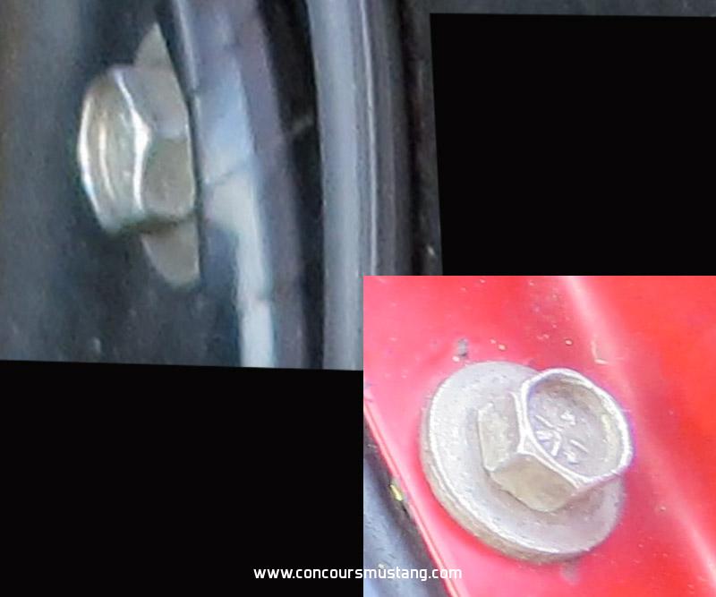

Ok took a look through my pictures and came up with some more examples where the head markings were visible. All of the ones I found used the wavy or toothed washers so that appears not to be a difference during the year and plant.
Removed my earlier post with the three examples so that I could post the pictures in order by their VIN in this one. In some of the pictures I also included the fender bolt also. Often they matched but not all the time. Expect that we will visit fender bolt markings in another thread in the future
9R11107x  S marking
9R111547 Head marking not visible
9R113512 Head marking not visible
9R115596 RBW counter sunk head
9R120249 Looks IMHO to be RBW counter sunk head
9R12028xx back to S marking
9R13593x Head markings not visible
9R14651x S marking
9R170501x  May be the counter sunk RBW
Looks like so far there were two suppliers and we can start to see when each was available and used during different periods of production.  Have one more section in my files to check for additional original examples

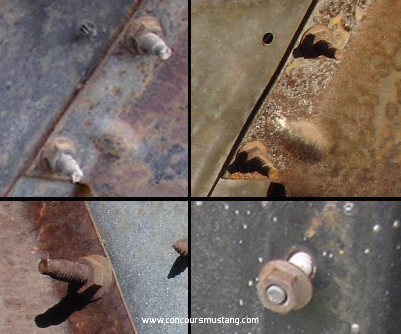

Just a picture of the wheel well side with the length and design of the bolt tip and nuts
« Last Edit: December 06, 2022, 06:14:33 PM by J_Speegle »

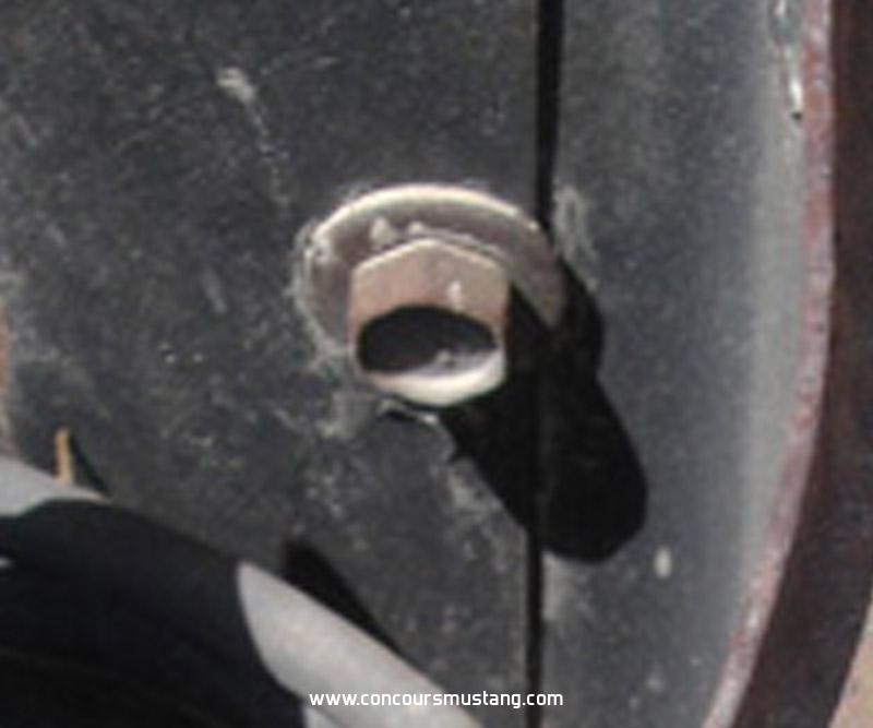

The first pictures with the actual bolts are an unrestored October68 built 69CJ,San Jose.9R02R107xxx  The pics with just the fender apron and no bolts is my car, September68 built 69CJ San Jose.  9R02R107xxx.  Another note.  My fender bolts were like the pic posted by BUZZ489.  Has anyone else have the fender style bolts that say "NAT"?
  • Posts: 24919
« Reply #7 on: December 10, 2022, 05:58:49 PM »
For others your referring to the fourth picture as those being found on 9R02R107xxx with the sunken RBW style
Don't see any fender bolts shown in that (reply #2) post. Just inner fender ones Might be a typo
If I recall correctly those are hardward bolts and what was sold as "reproduction" or replacements in the past
