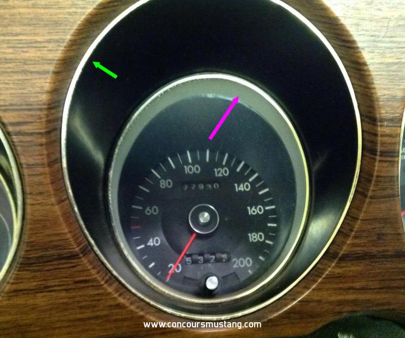

Hi guys,
Has anyone freshend up their instrument panel?
the outer rings of the trim? - can you use an chrome pen? or is the outline gold?
Many thanks

« Reply #1 on: January 03, 2023, 08:29:26 PM »
Outer (green arrow) ring?
A chrome paint will likely work ok though originally I believe it was a vacuum coated foil like finish. Mylar tape or sheets could be used to replicate but is not a fun job given the round shape and the sheets or film you can purchase that I'm aware of

« Reply #2 on: January 03, 2023, 08:51:24 PM »
I had my outer trim rings vacuum plated 20 years ago and they still look new.  I used a company in BC CA, but I don't think they are in business any longer.

« Reply #3 on: January 03, 2023, 10:43:07 PM »
I had mine done at Vacuum Orna-metal about 4 years ago. They did a great job.

« Reply #4 on: January 04, 2023, 12:27:35 PM »
https://vacuumorna-metal.com/content/restoration
+1 on Vacuum Orna-Metal.
Close to the same price as a new repop, so why bother?

« Reply #5 on: January 04, 2023, 05:26:51 PM »
CV Vacuum Platers is out of business but recommendations have gone to  https://muellercorp.com/
